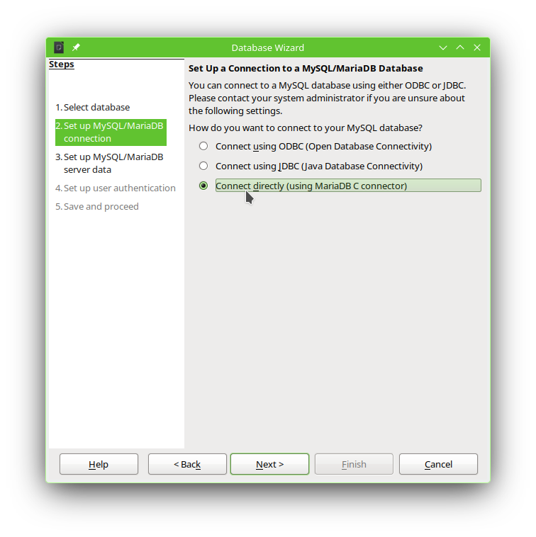

@CRDF The other thread was about JDBC-connection. We had solved this.
This thread is about the direct connection, which works in all versions up to 25.8.4.2 and also 26.8.0.0.alpha0+, but won’t work with LO 26.2.0.3. Its a driver LO supports.
You could test this without any MySQL/MariaDB-installation:
Press Base Database in main window.
Wizard for database appears.
Choose “Connect to an existing database” and → “MySQL/MariaDB”
Next: Choose “Connect directly”
Next: Database name ‘test’, Sever ‘localhost’
Next: User name ‘test’, Password required. → Test connection (Password: some characters).
You will get
A driver is not registered for the URL sdbc:mysql:mysqlc:localhost:3306/test.
Driver isn’t there
When using LO 25.8.4.2 you would connect or get an error, if database doesn’t exist.

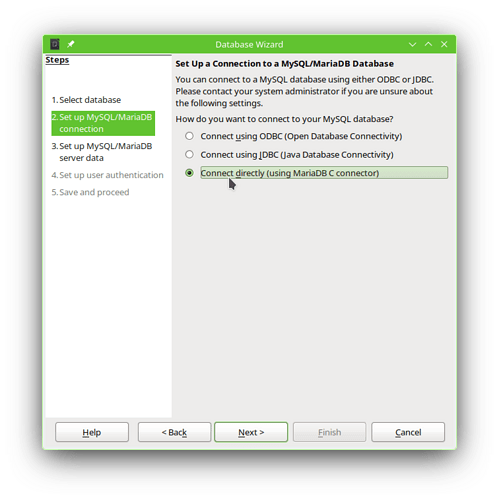

@CRDF : Your thread is about connecting to MySQL/MariaDB without any native driver (which is missing on your system, because it isn’t available or isn’t installed). So you couldn’t use this kind of connection. You haven’t installed all packages, which were available from www.libreoffice.org.
Here is how it looks on LO 26.2.0.3, installed with original packages, for me here:
The dialog shows the direct connection, but you couldn’t connect, because the driver isn’t registered.
