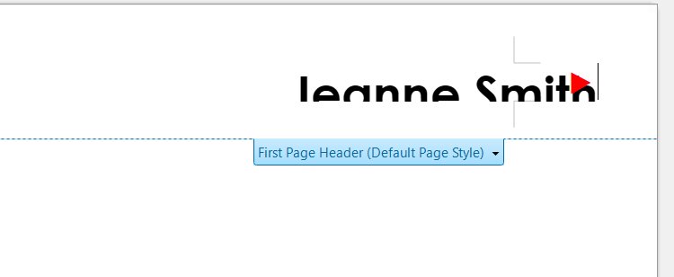

I set up a template to serve as stationery. It has my letterhead in the p. 1 header and the header on later pages is blank. I typed a long letter and now I’m not sure what I did. I deleted a lot of stuff. Anyway, my multi-line header on P. 1 is cut off with a little red triangle.
The trouble is that I’m looking at the template and the document side-by-side and I can’t see how to fix this. I’ve reviewed the margins and the header settings and they are identical. But the letterhead is fine on the template and effectively gone in the document based on that template.

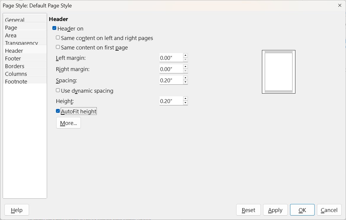

A ref triangle means some contents could not be displayed within the limits of the “container”. The container here is the header. By default, a header “auto-sizes” to account for the volume of the header. But, you can force the header to a fixed height if your layout requires it.
Open the page style corresponding to the faulty header and go to the Header tab. Check if the AutoSize box is ticked or not.

I cannot disguise the info in the problem file because I cannot get into the header to edit it. See letterhead.jpg (attached). When I do click in the name at the top, I can use the delete button, but the subsequent lines of the letterhead (address, etc.) do not appear. Nothing appears.

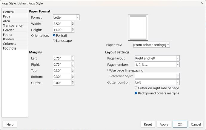

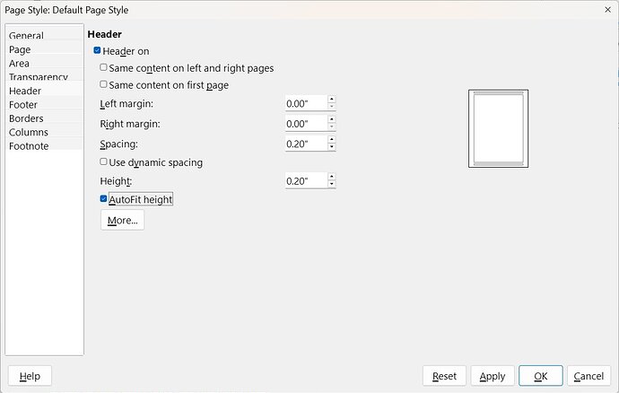

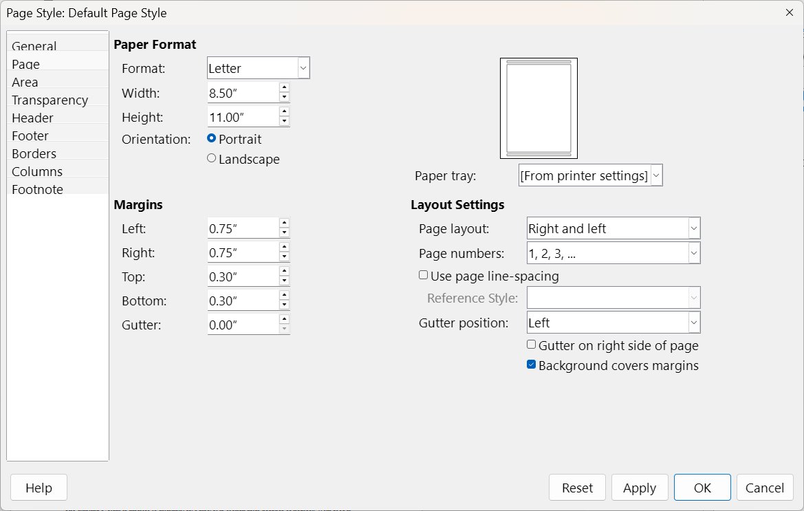

If I don’t hit some limit, I’m attaching workfile-header_format.jpg and workfile-pg_format.jpg. Note that it’s not quite identical to the template. I slightly adjusted the page margins in the work file, but that was days ago. And again, I’ve used this format for years and have been working on this file for a week or so.
