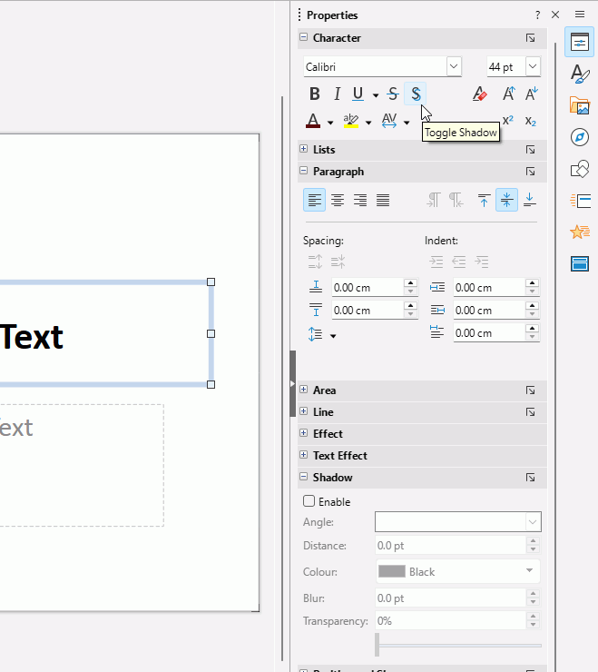

If the presentation is saved as .odp then it could be modified. There are two ways to add a shadow to text in Impress. In the Sidebar > Properties either
  1. Select the text or text box and click the icon with tooltip Toggle Shadow. Or
  2. Expand the pane labelled Shadow further down and tick the box Enable. Play with the settings to reduce the effect, say Distance 0.2 pt and Blur 0.1 pt
