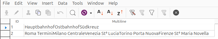

but when imported, whether or not checking the CR/LF block in the import wizard, this results in
1 1/2 cups chicken stock8 oz fresh/refrigerated rice cakes1 1/2 Tbs gochugaru

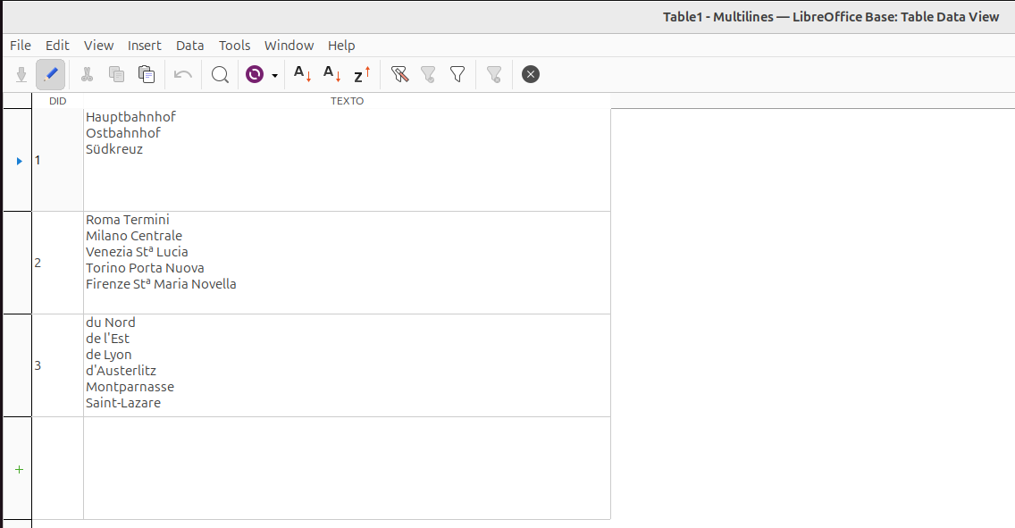

In the “transit” DB which directly connects to the Calc file, multiline text displays :ok:

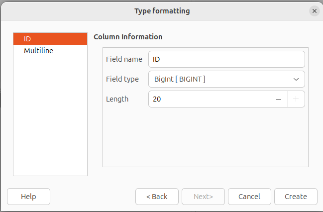

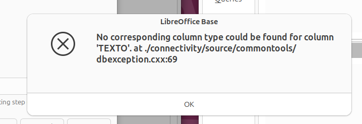

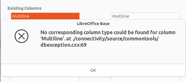

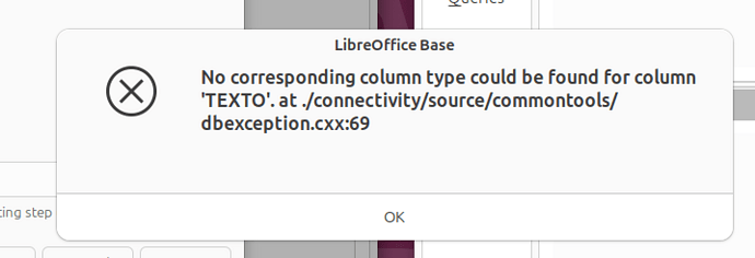

Paste or drag > Table = “Sheet1” > Create pk “ID” > Type formatting > Create > Refresh Tables = nothing.
:thinking:
NoCorrespondingColumns
Tables
TypeFormatting
Tried it all ways I could imagine to no avail.
Made pk Decimal apparently :ok:

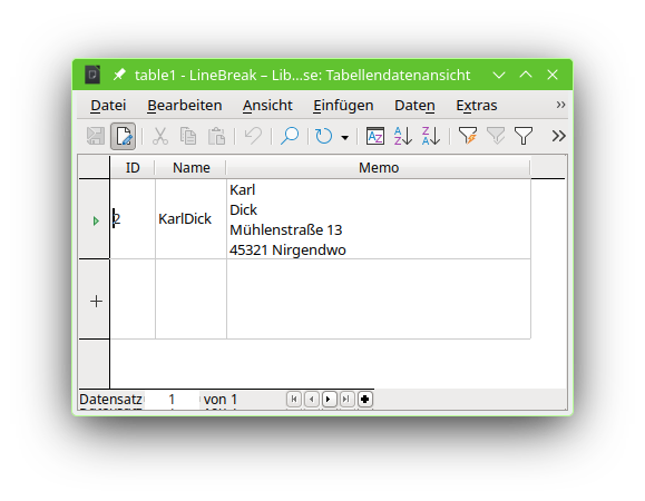

There will be 2 Base files:
1 File, which connects to the *.xls-file (for example: DB_xls.odb)
1 File, which connects to the database you want (for example: DB_HSQLDB.odb)
Copy the tables from DB_xls.odb to DB_HSQLDB.odb and the multiline fields will be copied if you set the type for the field to “MEMO”.
grafik
Looks like this: “Name” is only VARCHAR, “Memo” is set to Memo [ LONGVARCHAR].
Don’t copy tables from Calc directly to DB_HSQLDB.odb, because the multiline content will be shown only in one line.

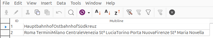

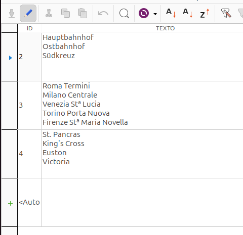

Was now able to complete the task.
  1. Insert a numeric id in A
In the “independent” (second) DB:
  1. set pk type = DECIMAL, no auto;
  2. set text type = BLOB SUB_TYPE TEXT.
Gares of Paris inserted in this DB.

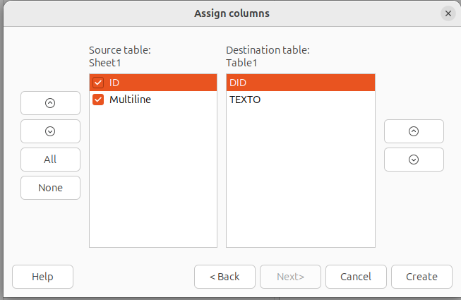

ColumnsMapping
MultilineForm

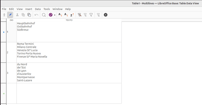

to fill up the so to speak “transit” table in the “intermediate” DB “DB_xls.odb” as per @RobertG’s nomenclature.
Of course. After inserting the data from “transit” table into table of the definitive (“destination”, 2nd) DB, import is finished.
As you can see above, I inserted Paris’ gares names in this permanent DB. No relation with the old spreadsheet.
Record #3 has no relation at all with the original Spreadsheet “database”:
This is the start of the problem: A Base file is only a GUI, which connects to a datasource. Have a look at the status bar of your “Base file”.
grafik
If you have “created a Base file” this will be the default. The Base GUI connects to an embedded database. It is called HSQLDB.
grafik
This is a Base file, which connects the GUI of Base with a spreadsheet. The status bar will show the connection to the Calc file “Calc_Linebreak.ods”.
I created this file only for copying the tables from Calc to the Base file for the embedded database. There won’t be a (permanent) connection between the embedded database and the Calc file.
You could also copy tables directly from a Calc file to the Base file with embedded database. But you won’t see any linebreak in the imported data when copying this way.
3 STEP Solution without steps 1 and 2
In the destination “db.odb” DB
1
CREATE TABLE TT (TEXTO BLOB SUB_TYPE TEXT NOT NULL);
without pk!
2
Drag the linked table from “DB_xls.odb” over TT icon in “db.odb” DB
> Append data.
3
Create the real production table “Table2” the usual way:
  • ID pk auto
  • TEXTO BLOB SUB_TYPE TEXT
4
INSERT INTO "Table2" SELECT TEXTO FROM TT;
Tabela2
