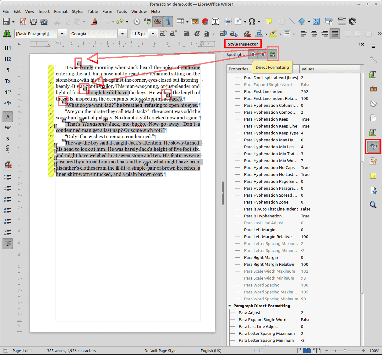

I did some testing on your sample file. Others have already mentioned most points.
Though you have embedded Georgia font, I don’t think it is automatically used by Linux; I suspect it is still substituted.Not sure about a possible font issue, I tried to trigger different hyphenation points and line distribution. So I changed font size slightly. Curiously, as soon as I request a size larger then 13pt, LO crashes.
I manually forced Liberation Serif on the whole text, with a dramatic change in text layout, but font size change still causes crash above 13pt.
I copy-pasted text in fresh documents (standard paste and unformatted text paste) with the same result.

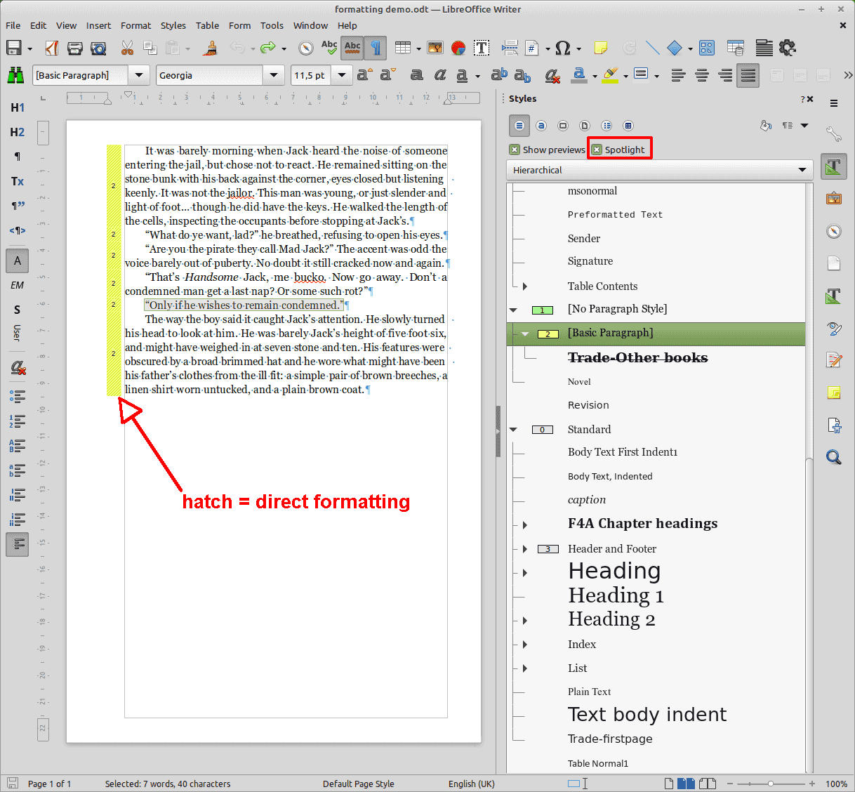

Next I looked at the XML encoding which revealed a very bad mixture of direct formatting. One case is manual change in several locations to Times New Roman. This was not visible probably because of font substitution on my machine. Another case is “professionalism fault”: you manually applied italics on character’s nickname. Italics can be used for purposes like emphasis, quotation, foreign expression, irony, … If you direct format them, you can’t manage them separately. You should apply a character style representative of the specific meaning (semantics). Built-in Emphasis is available for emphasis. You must create dedicated character styles for the other nuances.
As a general rule, “professional” documents should contains absolutely no direct formatting, at least as far as typography is concerned; direct format is acceptable though for text flow (e.g. exceptional page break). FormatSpotlight feature is the tool of choice to hunt for formatting tuning and direct formatting highlighting.
Character styles are frequently neglected because the notion does not exist in Word (from this point of view, Word is not a “professional” tool because it does not implement styles apart from paragraph, relying on direct formatting for the rest).

btw, how do you see all the styles that are attached? and where I’ve used direct formating? How do I see that?
For that I know two ways (see attached screenshots):
