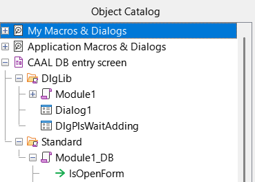

I’ve tried in vain to find any documentation that can help me with your code. If can point me in the right direction that would be great.The dialog DlgPlsWaitAdding is not stored in ‘My Macros & Dialogs’ or ‘Application Macros and Dialogs’ but under the application itself ‘CAAL DB Entry screen’ if that helps, and the code is all stored in Module1_DB.(see pic)
