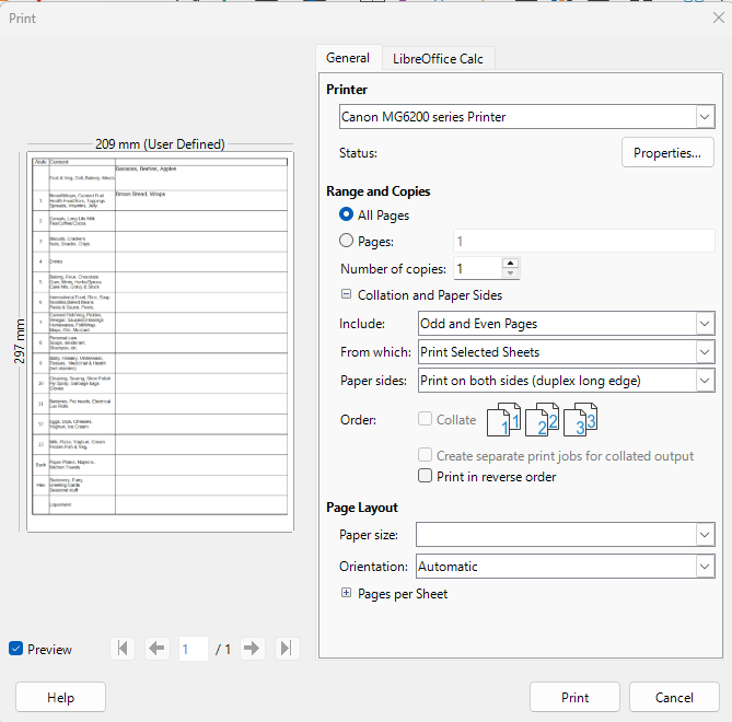

I changed the paper size to 209 wide rather than 210 and when I select File > Print the little preview looks OK and, if I print immediately, it works.

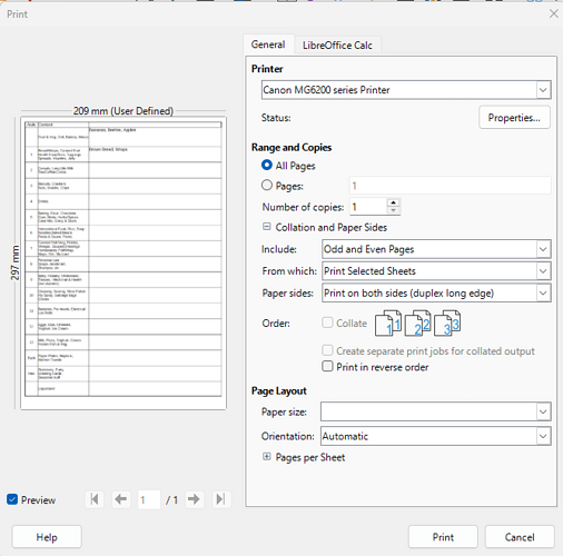

I go to File > Print and the following window appears.

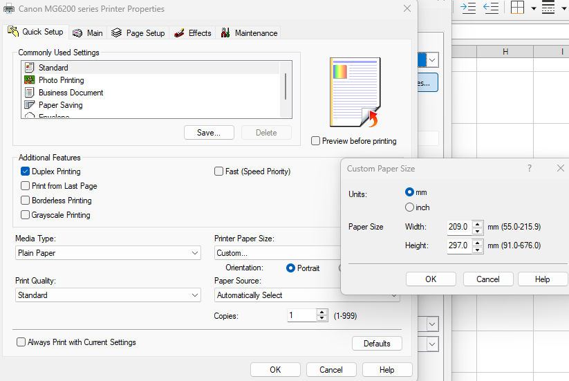

I then select Properties, below the printer name, and display the custom page details and get this:

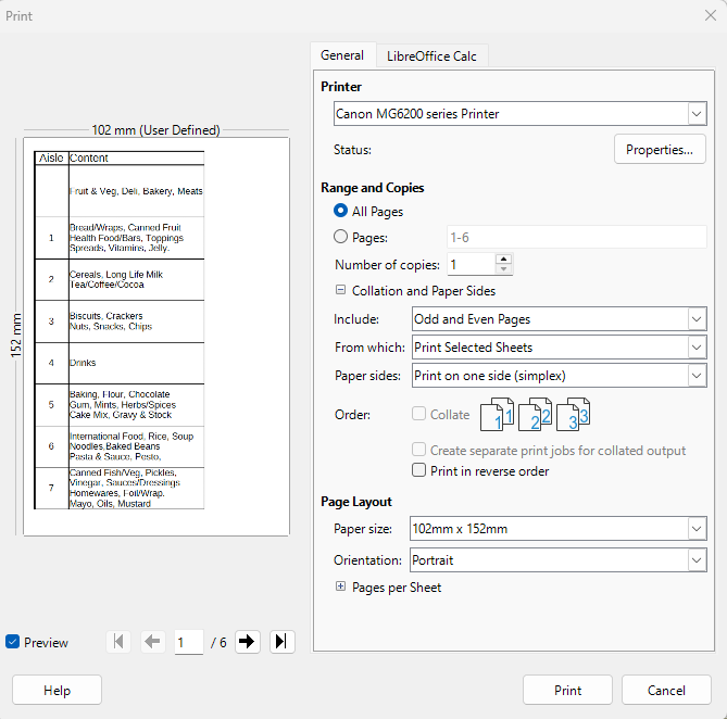

Finally I uncheck the Duplex Print checkbox and return to LibreOffice, when I see this:
OK. I can replicate that, it doesn’t seem too different from earlier bug.
