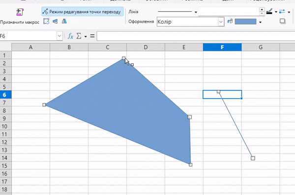

When trying to edit a created polyline, I encounter the following problem: there are “forbidden vertices”. That is, some vertices behave normally, and some vertices reset the editing mode and arbitrarily switch the editing mode to rotation. I had version 25.8 and I updated to 26.2 but the problem did not disappear. How to make it stay in editing mode.
Записування 2026-05-01 123908 (1)
