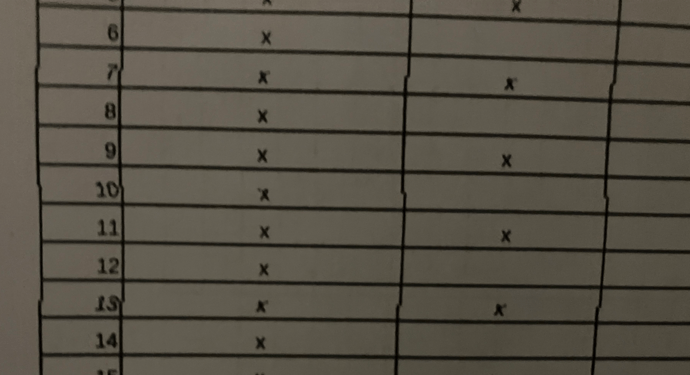

Print shifting left and right when printed on a Canon MG4200
I have an issue printing from LibreOffice, both from writer and from calc.
When printing the print is shifted a little left or right every other centimeter. Which means that some text lines looks like they are in cursive and straight lines are not printed straight.
My PC is a Thinkbook 14 with Windows 11 Pro and I use a Canon MG4200 printer.
I have tried to remove the printer and reinstall, this helped on another issue I had, but not the shifting.
Any idea what to do?
Try aligning the print head, See Canon Support
Have adjusted the printer head twice now, but the shifting is still there.
Can you manually align them as shown in the link? Or preferably the manual for your printer.
BTW this seems to be purely a printer issue, not LibreOffice
Perhaps there is a way to force the printer, to print only in one direction, maybe a bit slower but good.
Thank you for all your help leading me in the right direction.
It certainly seems to be a printer issue and not LibreOffice, only thought so since it seems to print fine from PDF.
I have not yet managed to get the printer head aligned, but I will keep working on it with your suggestions.
