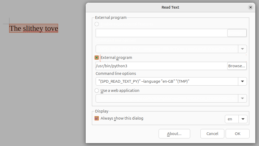

I’m using LO 25.8 Writer on Ubuntu 24.04 and have installed the Read-Text extension.
I have speech-dispatcher with rhvoice installed and this does work from the command line.
I have configured Read-Text to work with speech-dispatcher according to the instructions but all that happens, regardless of anything I try is that it pushes the text to Google Translate.

If LibreOffice is installed as a Snap then I suppose it is sandboxed and cannot access rhvoice. It might be worth pursuing that avenue in Ubuntu forum
That’s an interesting point about the sandboxing, yes it is installed with snap. For now I’ve uninstalled LO completely, and purged it with “apt”, as I had some leftovers from a previous apt install being awkward.
So that’s all clean. We’ll see what happens on my other post and come back to this if needed.
