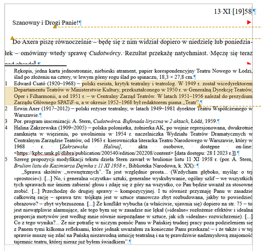

after saving a document in writer i have some strange issue.
In parts of the text, where I used section, parts of the text are hidden under red arrow.

Here is the sample of file. I don’t use here any specific objects besides sections.
Sample.odt (17.8 KB)
Also, like in the sample I send above, sometimes text is hidden and red arrow also is not visible.

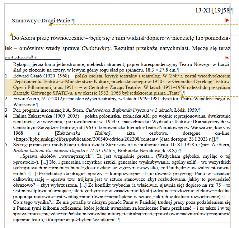

Problem: footnotes anchored to page or anchored to end of sections
In my view you wrongly have anchored the footnotes in separate sections as endnotes.
You better could do it without sections and anchoring footnotes at the pages’ end (i.e. simple footnotes).

The red arrows disappear after Tools
>Update
>Update All
(here LO 7.4.6.1 under Fedora 39, KDE Plasma desktop).
I can’t read Polish but I suppose your document is a series of letter fac-similes with notes. If the sample is representative of the global document, the “letters” are relatively short, then I think footnotes could fit your needs without the complication of sections. As an example I converted your endnotes to footnotes with number restarting at each page: Sample-ajl.odt (44.9 KB)
Some care should be exercised on “letters” where the combination of “letter” and notes flush the salutation and signature only on next page, resulting in a not so nice layout. But, generally, it meets your design.

I found temporary solutions. Adding page breaking and forcing endnotes to start on a new page solves for now, but I think combination of sections, short text and long endnotes forces bug.
