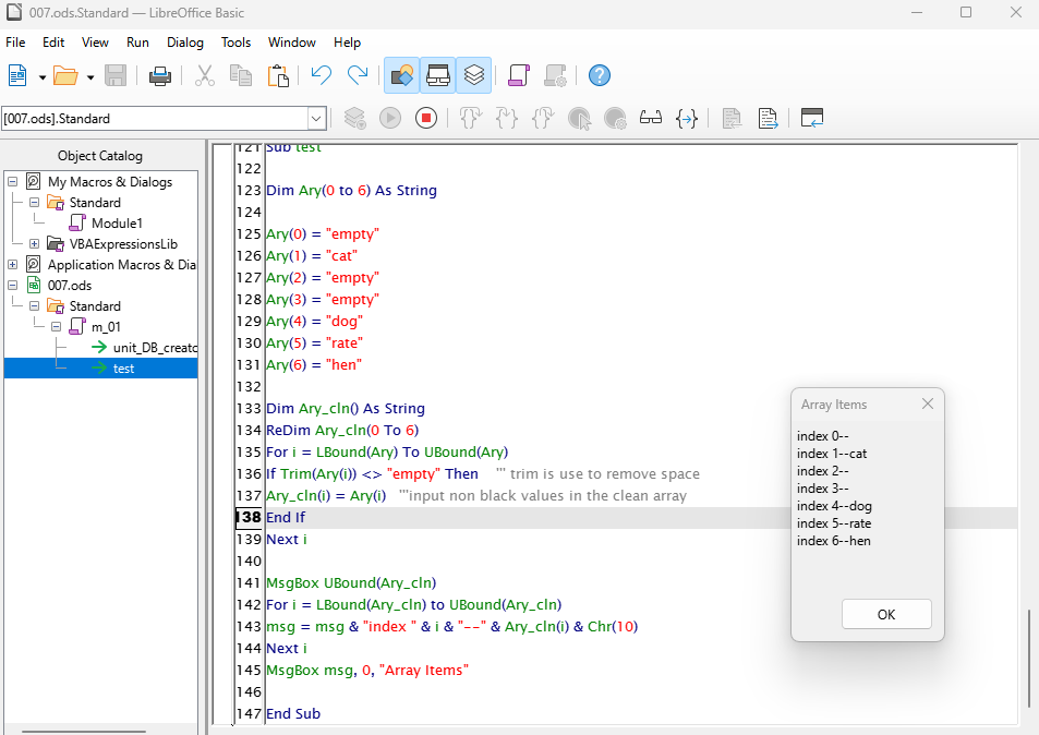

but when I run the code the Ary_cln is equal to Ary with “empty” replaced with “”. refer following snapshot

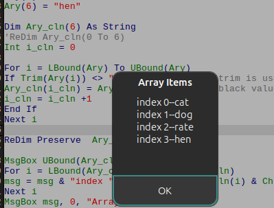

Ary_cln(i_cln) = Ary(i)
i_cln = i_cln +1
then
ReDim Preserve  Ary_cln(i_cln-1)
then probably directly easier with
ScriptForge.Array service (SF_Array)
ScriptForge.Dictionary service

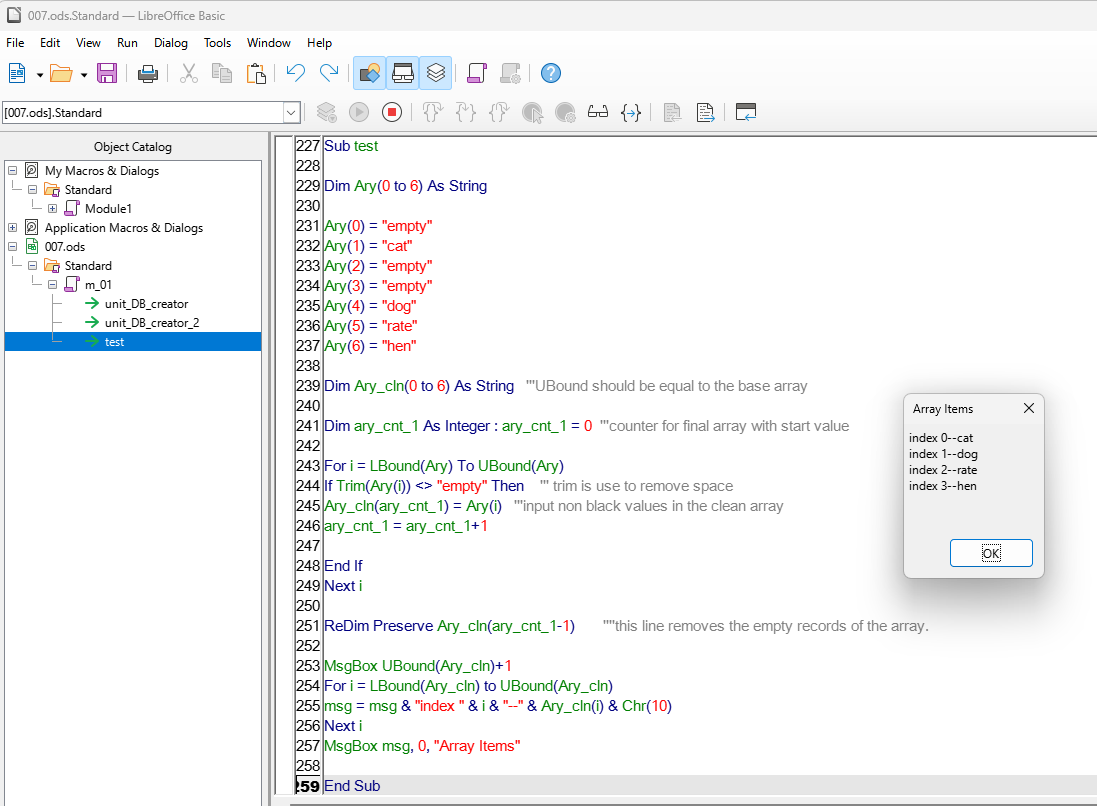

Much Thanks for your inputs and suggested code. I have revised my code as per your suggestion.
What I have observed is given below for others like me to understand.
The following code does complete job.
Sub test
Dim Ary(0 to 6) As String
Ary(0) = "empty"
Ary(1) = "cat"
Ary(2) = "empty"
Ary(3) = "empty"
Ary(4) = "dog"
Ary(5) = "rate"
Ary(6) = "hen"
Dim Ary_cln(0 to 6) As String   '''UBound should be equal to the base array
Dim ary_cnt_1 As Integer : ary_cnt_1 = 0  '''counter for final array with start value
For i = LBound(Ary) To UBound(Ary)
If Trim(Ary(i)) <> "empty" Then    ''' trim is use to remove space
Ary_cln(ary_cnt_1) = Ary(i)   '''input non black values in the clean array
ary_cnt_1 = ary_cnt_1+1
End If
Next i
ReDim Preserve Ary_cln(ary_cnt_1-1)       ''''this line removes the empty records of the array.
MsgBox UBound(Ary_cln)+1
For i = LBound(Ary_cln) to UBound(Ary_cln)
msg = msg & "index " & i & "--" & Ary_cln(i) & Chr(10)
Next i
MsgBox msg, 0, "Array Items"
End Sub
Refer below snapshot for the destination array.

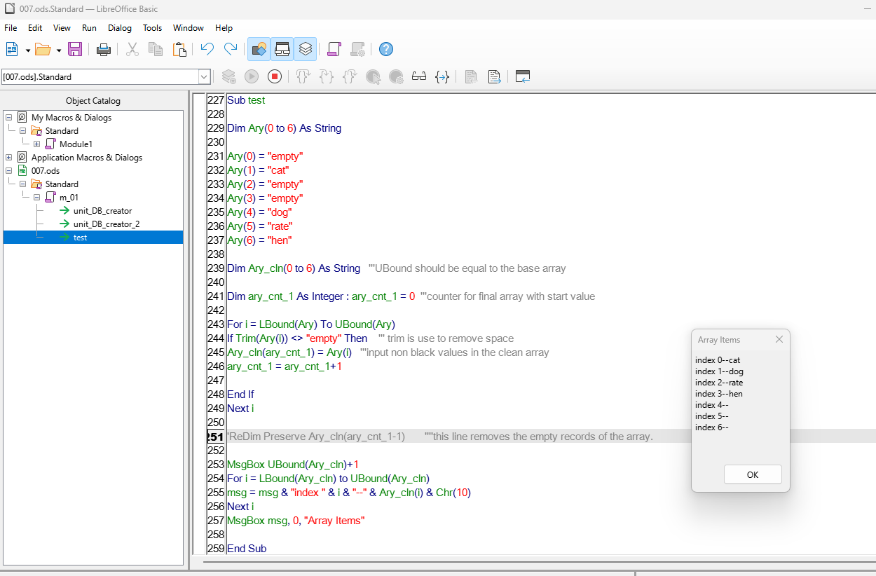

If we comment out the following line.
''ReDim Preserve Ary_cln(ary_cnt_1-1)
then it can be seen that resultant array has some empty records in the end. Refer the following snapshot.
So this is very good point highlighted by @fyp.
After finalization of arrays, use this command to remove the blank records of the array.
