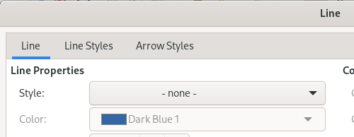

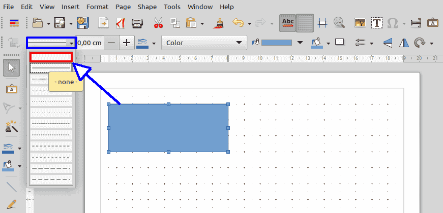

When using draw it seems that the shapes (rectangle for example) have a solid black outline. I want to get rid of these. I right click on the shape and select “line” and under “styles” I see quite a variety of lines but no options for “no line”.
How do I get rid of the lines?
thanks
Fritz
And you can edit the Default Drawing style to not include line.
