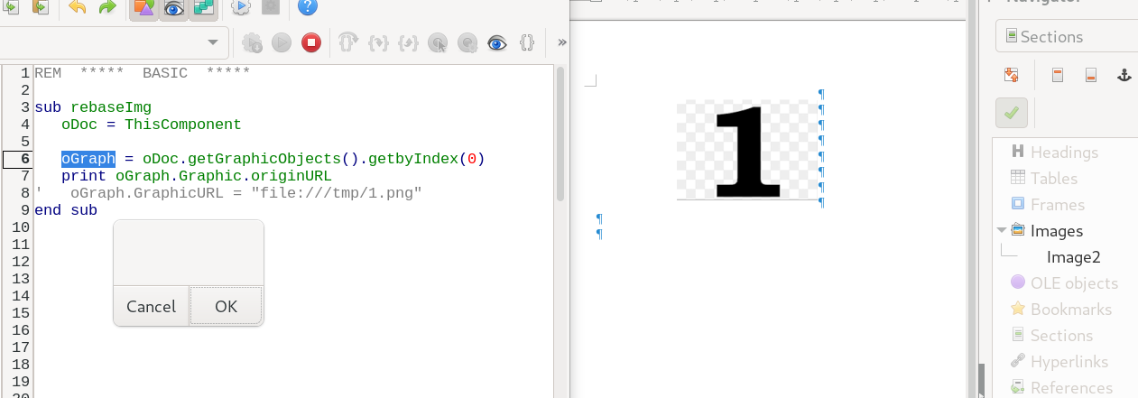

seems this is not working anymore (24.2 or master) :thinking:
any update ?
@fpy I tested it without problem, Libre 25.2.3.2 Win10x64.
Have you correct path in variable sImageFile?

@KamilLanda, thanks for following up, I could then spot the problem;
actually assigning .GraphicURL works,
however with a side effect after a first change, the property .OriginURL gets empty !? :thinking:
img.odt (11.3 KB)
any thought welcome,
Graphic.OriginURL contains a link to an external file.
In img.odt document, the image is embedded, not a link.
Got the problem. :slight_smile:
After replacing the link, the image becomes embedded.
I don’t know the UNO method to insert an image as a link.
Found it (good thing we’re dealing with open source software)!
