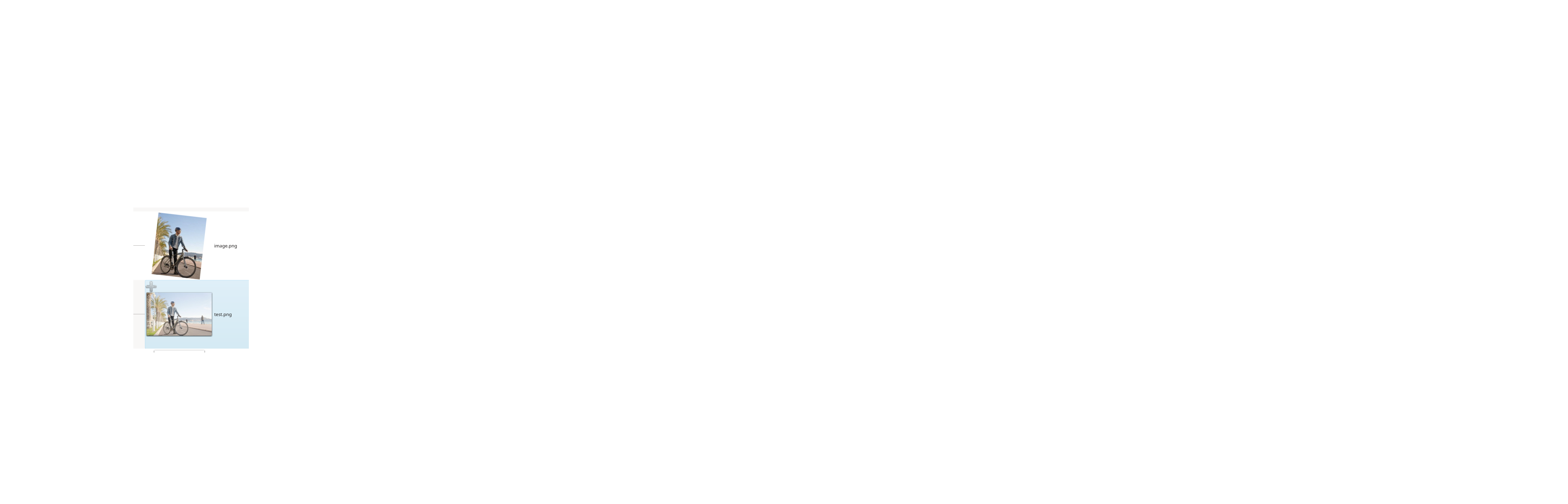

I’m still looking for a solution on my side. When using the Impress function “save” (Right-clic on the image and Save) Impress offer to save the modified or the original picture. With the original one, no alteration are save. The following first image is exported from my code. The second one manually with Impress save operation.
And if I use the replace part of my code with that manually exported picture it work. Obviously, save the original picture is possible, but at that point, I still do not know how to do it in a macro.
