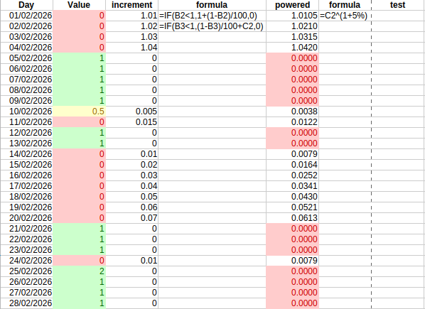

Let’s say i have this situation:
1.ods (31.3 KB)
1
How can i test each row so that it returns true only on the last row where the powered number is greater than 0, all the other to be false. In this case there would be 4 trues.
Also, i don’t know how to fix the increment thing, so it starts each time from a value >1 when the first value <1 is encountered.
How should i proceed?
Thank you.

The last value before a 0 is encountered, on the E column.
This means, “I expect “true” in cell X5, cell Y10, …” ? Please be specific.
@mikekaganski
Yes, it can happen multiple times on a column, not just once.
In this case it would be on 04/02, 11/02, 20/02, 24/02.
All the other cells to be false.

So, if you can’t type “I want to see “true” in G10, G14, G24, and G29 - because they correspond to E10, E14, E24, and E29, which are all the last 0 in adjacent zero series; and all other cells in G must be false” - you can’t expect others to guess that from purely textual description.
Try
=AND(E2=0;OR(E3<>0;ISBLANK(E3)))

For example: the first number, 1.0402, is the last entry before a 0, so it should show next to it “true”, same with 0.0122 and so on.
It is not the last 0, but the last value before a 0.

Formula
=AND(E2>0,OR(E3=0,ISBLANK(E3)))
I’ve reduced the spreadsheet:
LO-CALC_true vs false_094946.ods (19.2 KB)
Can you help me please also with the increment column, how to make it work past the first few numbers? I don’t know what i’m doing wrong.
It should start again from a value >1 when the first value <1 is encountered. As you can see, it starts from 0.01 or less.
