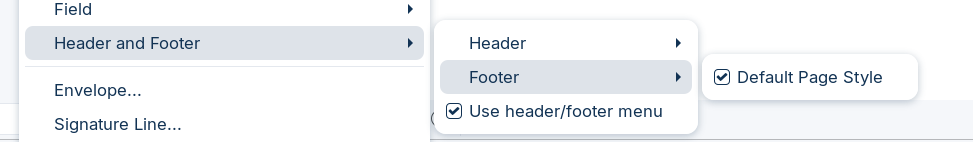

Quoting from the help page you linked above:
To Insert a Page Number
Choose Insert - Header and Footer - Footer and select the page style that you want to add the footer to.
This is probably obvious, but place your cursor in the header (or footer or wherever the field is to be inserted).
Choose Insert - Field - Page Number.
I’ve followed those steps in your supplied sample document; the result is attached. The numbering continues on page 2.

SWITCH ON the Footer and/or the Header in the applied page style before!
It will not work without a real Header or a Footer.
The Header and the Footer are special areas of a Writer page. You MUST use them for the working Page numbering.
Looks like it is on.
Special how?
Headers and footers - first paragraph
The constant text contents of the Header and Footer will be repeated automatically on the pages which have same page style. The PageNumber Field (what you put on one page) will be appeared automatically on the pages, and the value of the Field will be increased automatically. Not needed to type or insert them manually on every page.
In your sample file is switched ON: the Footer only. Use it if you need the Footer (insert the Page Number Field inside the Footer). (The Footer - as the name shows that - is located at the bottom of the Page.)
But, if you need the Page Number at the Top of the page, then you need to switch on the Header. Then you will able to insert the Page Number Field into it.

Here is YOUR sample file. I just switched ON the Header (the Footer was switched on, and then I inserted the Page number Field into the Footer and the Header of the first page.
Then I filled the document with some dummy text (Lorem Ipsum). Some new pages were created automatically by the text overflow.
The page number (the increased value) is appeared on the Footer and the Header of the other pages too.
