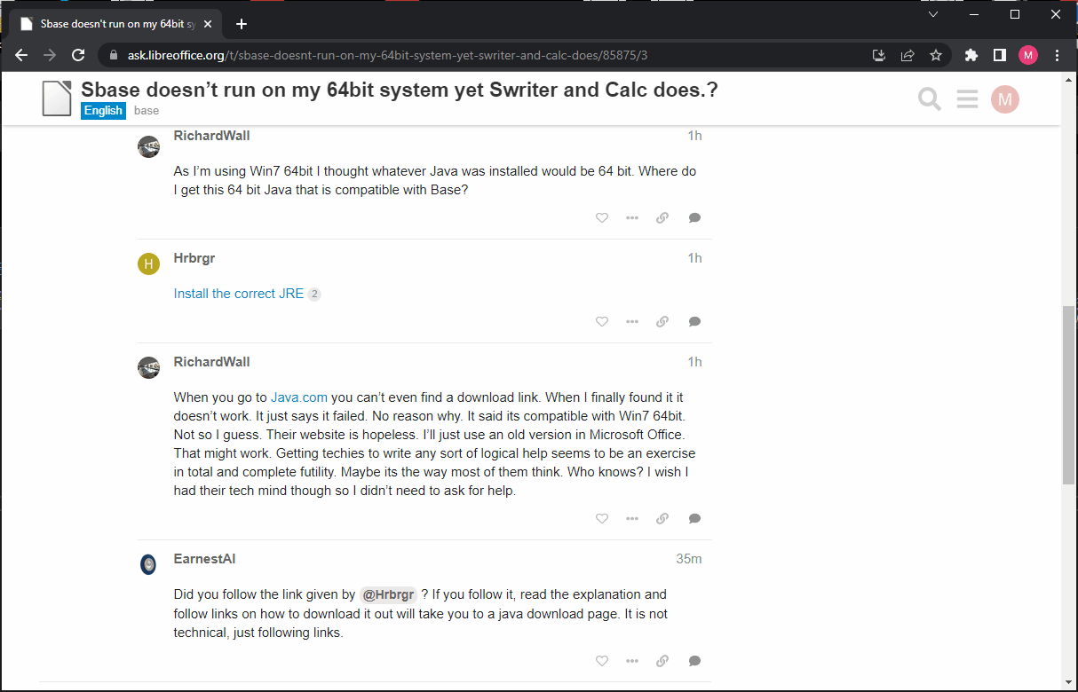

As I’m using Win7 64bit I thought whatever Java was installed would be 64 bit. Where do I get this 64 bit Java that is compatible with Base?
When you go to Java.com you can’t even find a download link. When I finally found it it doesn’t work. It just says it failed. No reason why. It said its compatible with Win7 64bit. Not so I guess. Their website is hopeless. I’ll just use an old version in Microsoft Office. That might work. Getting techies to write any sort of logical help seems to be an exercise in total and complete futility. Maybe its the way most of them think. Who knows? I wish I had their tech mind though so I didn’t need to ask for help.
Did you follow the link given by @Hrbrgr ? If you follow it, read the explanation and follow links on how to download it out will take you to a java download page. It is not technical, just following links.
