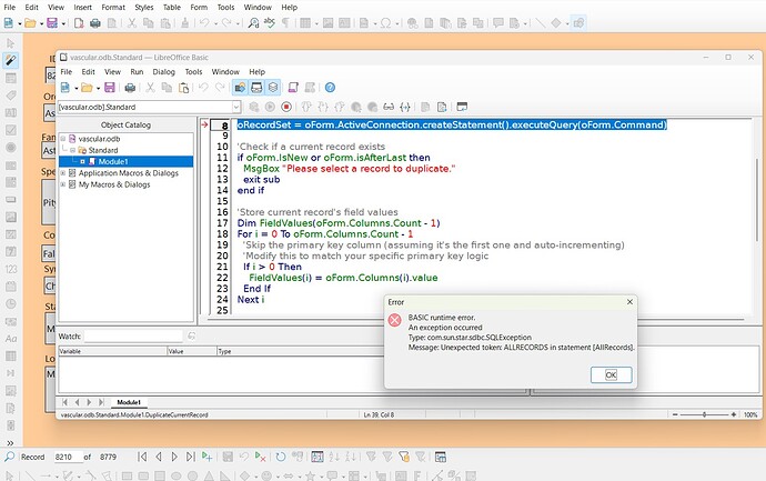

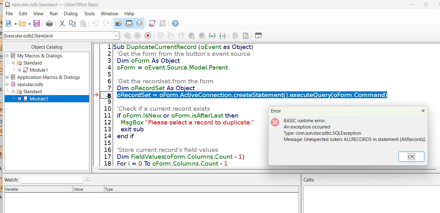

none of the proposed methods work. Attached is the error message I got with the macro for the radio button

Without a complete view to the macro code you can’t get an answer. There seems to be something you call “ALLRECORDS” and code doesen’t know anything about it.

AllRecords is the name of the table in my .odb file

these pieces remind me that when I tried the macro below (which I got from Google AI) as an action to be executed by a radio button on my form it failed via an alert box telling me that the INSERT command was not allowed
