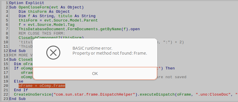

But
For this particular OP’s question we get the closing with 2 lines
Option Explicit
Sub OpenCloseForm(evt As Object)
Dim f As String, titulo As String
f = evt.Source.Model.Tag
ThisDatabaseDocument.FormDocuments.getByName(f).open
REM CLOSE THIS FORM:
titulo = Mid(thisComponent.Title, InStr(thisComponent.Title, ":") + 2)
ThisDatabaseDocument.FormDocuments.getByName(titulo).close
End Sub
This code is not reliable!
The document title can be changed at any time.
Using the setTitle method, the title can be changed after the form has been opened.

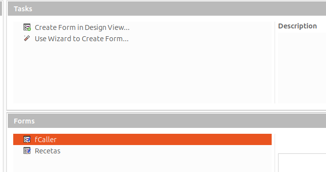

Let’s take this to context….
OP wanted a macro called from buttons in several forms to
- open some other form passed as a parameter;
- close caller form.
As the thread was not (and it’s not) marked Solved, just tried to contribute.
Of course neither user or developer are supposed to rename the forms via code, right?
As said above: of course I understand this is a generic solution.
It’s not about renaming the form.
We can dynamically change the title during work and reflect some useful information in it. I’ve seen such applications.
But let’s suppose during operation code changes the Title from actual “fCaller” to
“Useful Info”.
When the closing routine executes
titulo does not yet reflect this new Title?
Because it is not yet saved?
Let’s check.
Add a line
ThisComponent.Title = "Useful Info"
before the line
titulo = ...
