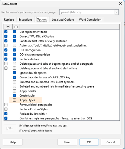

As to "I hit enter again right after the text HEADING in Heading 1 level. Expect it to go back to Default Paragraph Style. Goes to Body Text": the style that appears after Heading 1 (and after any style) is defined in that style's properties, as "Next style" property. For Headings, it's Body Text by default, so that part is expected and normal, and is configurable (using styles machinery), but the real problem is the previous part, as far as I can tell?
I am not at my computer but I vaguely recollect that in AutoCorrect options there is a setting to apply styles, this help page should supply the answer, While Typing (AutoCorrect)

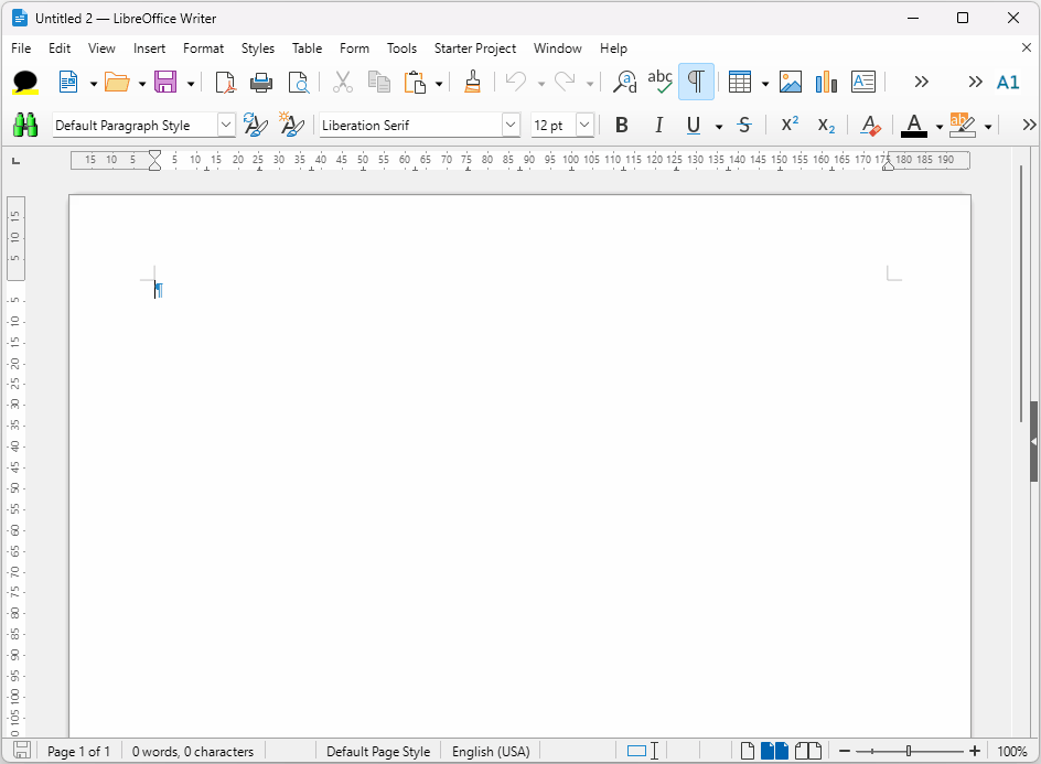

  • Untitled 1.odt (19.8 KB)
  • Untitled 2.odt (19.0 KB)
  • Hope someone can figure this out, not normal expected behavior, for me at least. Thanks for any help anyone can give.

Can’t reproduce the mishap on the two files you attached. Sounds to me as if you have some unusual AutoCorrect option to rework your typing.

LeroyG, thanks for that, I will try it and see if fixes the problem. Appreciate it.
LeroyG, I think you found it. That option was checked. When I opened a new document and repeated the process, it repeated itself just as it had been doing in the past. Deleted all the text and unchecked that box for Apply Styles. It seems to have fixed it, thank you so much. I am going to mark your reply as solution and put solved in the title.
If the misbehavior comes back at some point in the future then I will start a new question.
