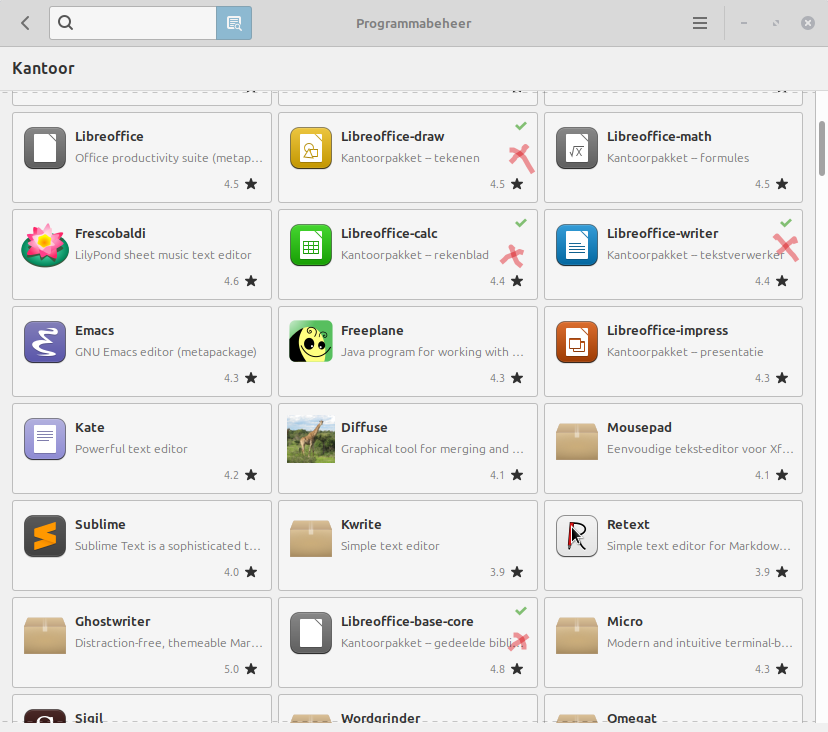

Which one shall I remove: all 4?

Why 4? I see 7 in your screenshot…
Maybe try to Search for “Libre” in the search tool in the upper left corner.
The image @Tineke has posted looks like Mint’s software manager showing all the Office applications, including LibreOffice components, that are available for install, whether installed or not. The applications that have a tick in the upper right corner are installed.
One can also obtain a list of installed LibreOffice components in a terminal using the command dpkg --get-selections |grep libreoffice
That explains the 4 modules, but we have still no idea what’s going on (or more likely is missing).
  • Without the report on Scribus I would suggest to install everything tagged LibreOffice and test again.

(To Wanderer: I see your 7, but only 4 are installed - which @Villeroy suggested I replace)
