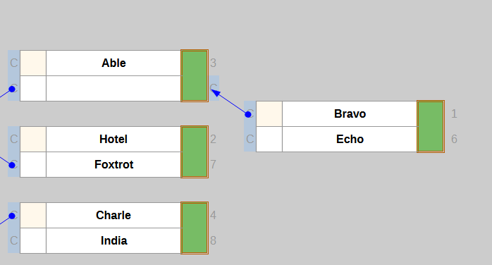

The 1st life numbers for players are coming up differently in 2nd life, ie Foxtrot is No.6 in 1st life but then pops up as No.3 and has the bye in 2nd life. How is that happening? It would suggest different numbering systems for each life?. If Foxtrot is allocated No.6 then he should be be in L14 Bracket in 1st life and for the 2nd life BB11. That is not happening as I see it.

Able is now in Foxtrots positions. Hotel is now No.1 in 1st life (has a bye) and No2 in 2nd life As No1 he should be in BB10.
Bravo is No3 in 1st life and should have the bye in 2nd life.

Hotel is 1 in 1st life (has bye) and 2 in 2nd. Wrong
Able is 6 in 1st and 3 in 2nd (has bye). Wrong
3 is Bravo in 1st and should have bye in 2nd. Wrong
It appears numbers are changing between lives or your ‘Seat’ system is altering things??. I did chang the 9 player Seats to suit as I see it. Maybe that is the problem as I may see the seat system differently to you
I see it as numbers are allocated randomly once and this determines the position/bracket they play in ie Able is 6 = L14 1st life and BB11 in 2nd (no6 there)

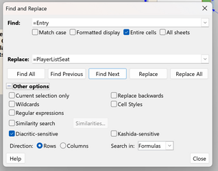

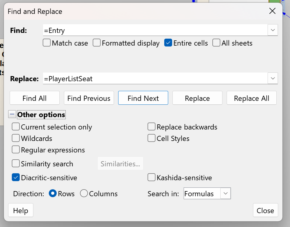

Have you tried comparing the names (thus the Alpha, Bravo, etc. for easy reference) to what you are expecting when you enter the numbers 1,2,3,4,… from top to bottom? How do the names come out, if you do that, compared to what you are wanting? That 1 is beside Hotel on the left but, say, 2 is beside Hotel on the right is not really the point…those numbers are not the seats, they are 1,2,3,4,… from top to bottom. The seats get looked up by the program. To see the player’s seat (before randomization), temporarily replace the =Entry where a player entry is with =PlayerListSeat. Then just press Ctrl+z to undo that once you’ve see the seat number. You can even check the whole page. Just press Ctrl+h for Lookup/Replace. Then adjust according to the following:
being careful about all the details, and press Replace All. Look at the seats as needed, then press Ctrl+z to get back the names. Those seats are what should match the seating you gave on the _ByeBrackets page. If they don’t, it’s a matter of quick adjustment on the _SeatLookup page. A real issue would be like getting a number repeating, an error, a blank space, etc. That would be more of a head-scratcher.

If we refer back to my ByeBrackets sheet 9 Players 1st life = 1 has bye in 1st Life so is in L8 bracket (1=Hotel, correct) and 2&3 (Echo, Bravo, correct in F10&11) all others are correct. That’s exactly to specs in ByeBrackets.
But below the 1st life brackets on the ByeBrackets sheet is the 2nd life bracket setup and none are in the correct slot as depicted there.
Hotel is 1 so should be in BB11 and No6 (Able) should be in BB12.
Bravo (No3) has 2nd life Bye so should be in AV8.
So the 1st life is as depicted but the 2nd life is totally different to ByeBrackets . It’s got to match, otherwise is not acceptable.

But also note: Look at the _ByeBracket for 9 teams for 2nd life:
It looks for the world like it wants 3,1,6,2,7,4,8,5,9 as the player seat from top to bottom. That’s exactly what the un-edited _SeatLookup table would provide if, for a matching real bracket page, the numbers entered going top to bottom would be 1,2,3,4,5,6,7,8,9.
