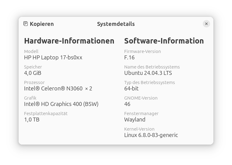

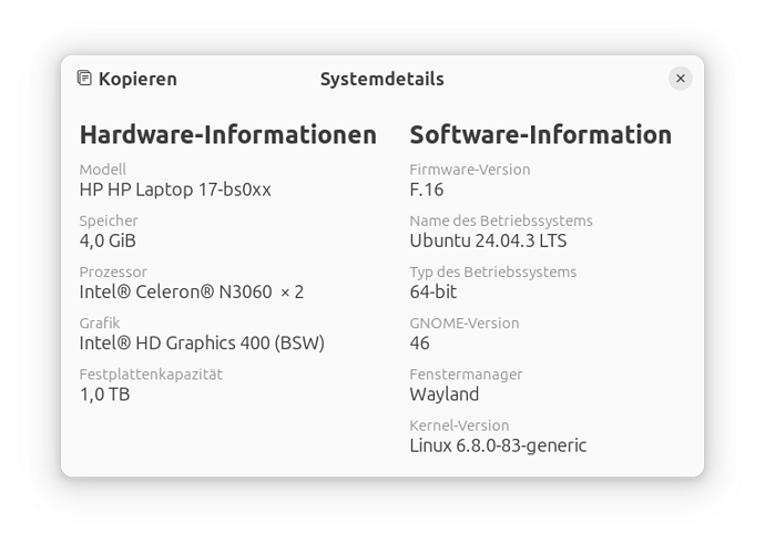

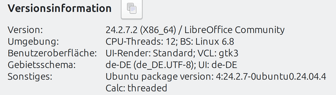

here is my LO and Ubuntu versions I’m currently using. I am on a ca. 6 years old Lenovo Thinkpad.
The funny part is, that the same dialog (including LO and Ubuntu version) is working just fine on my wife’s hp-laptop (at least 10 years old).
