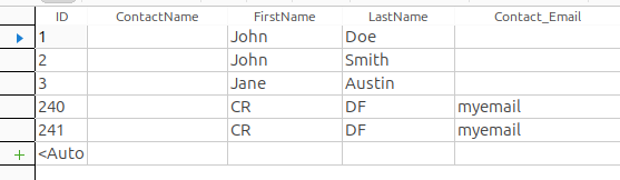

Add a simplified DB, so we can figure out it in a practical environment.
TestContacts.odb (2.9 MB)
I kept all the table headings, but deleted the data and added some fictitious names.

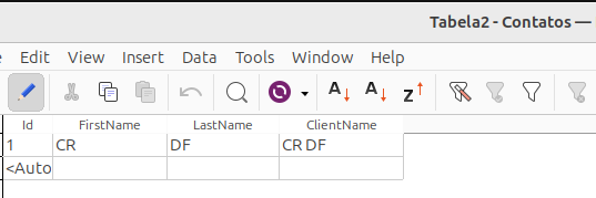

  3. Via Computed Column:
CREATE TABLE "Tabela2" (
    "Id" INT GENERATED BY DEFAULT AS IDENTITY PRIMARY KEY,
    "FirstName"  VARCHAR(25),
    "LastName" VARCHAR(25) NOT NULL,
    "ClientName" GENERATED ALWAYS AS (COALESCE("FirstName" || ' ', '') || "LastName")
ComputedColumn
Attached DB contains options 1 + 3:

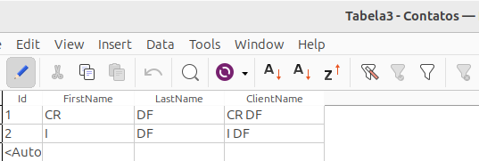

Contatos.odb (13.4 KB)
This is a trigger for INSERT into Tabela3 (= Tabela2).
Of course should exist also one for UPDATE.
CREATE TRIGGER CLIENT_NAME
FOR "Tabela3" ACTIVE BEFORE INSERT POSITION 0
AS
BEGIN
  NEW."ClientName" = COALESCE( NEW."FirstName" || ' ', '') || NEW."LastName";
END
TriggerInsert
