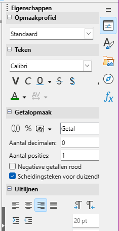

Hi, with numbers in a column it’s sometimes good to align them to have an indent from the right so the numbers are visually in the middle of the column.
According to the instructions Alignment this is not an option,
and also when you open the “Format - Cells” window and choose the “Alignment” tab, the field for indent is grey when choosing “Align Right”.
But i can do **indent from the right ** by choosing “Align Left”, set the indent to 10 or 15, and then choose “Align Right”
Can this be corrected in the app (not grey out the Indent field when Align Right is chosen) and on the Help Alignment page?
Background: i think i my calculation tool inherited this format from Excel. I like it (see the right aligned amounts in the picture) and when i lost this format in some cell i was not able to get it back - until today :slight_smile:
When using the side-menu as on the second picture, i can not use the trick described above, but i can add right indent by choosing Align Right and then use the More Indent button. This gives steps of 10 pt, while the window (showing “20 pt” on the picture) remains gray :slight_smile:
