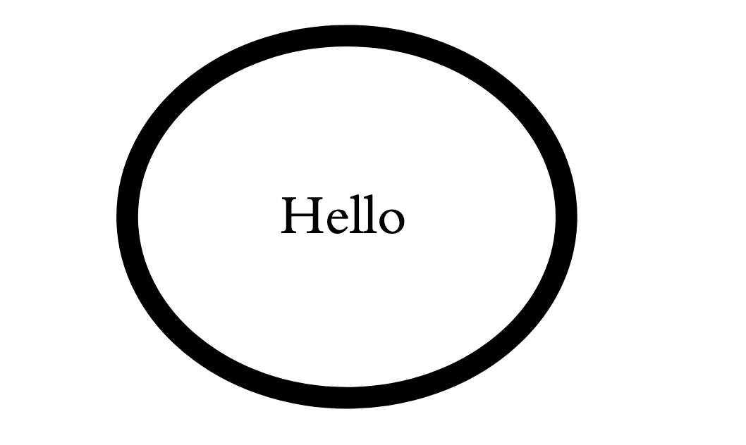

I created this vector using Inkscape, which looks like this:

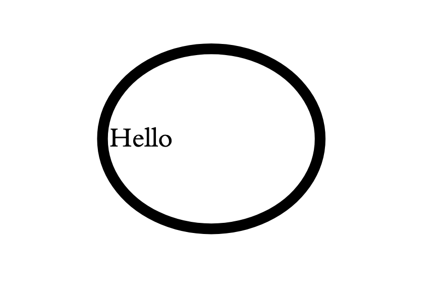

But whenever I import it into LibreOffice Writer, the text gets displaced:
I tried this on the latest LibreOffice 25.8.1
I uploaded the file here which everywhere else looks fine:

Have you distorted the image? It displays as an ellipse with major axis 10:00-16:00 orientation.

I can confirm that the word “Hello” changes its relative position when opened on LibreOffice. If it is displayed on Firefox the text is centered.
Seems to be a bug.
Workaround
Before exporting from Inkscape to SVG transform the text into curves (path). You cannot edit this transformed text as a text again. When saved as a SVG file the transformed text will be centered if opened on LibreOffice Draw.
