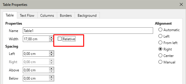

In the same dialog, Table Tab check if is checked Relative Width
