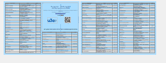

Each month I produce the attached document with some small changes and additions. It comprises 2 pages of A4 landscape, which are double-side printed and folded to create an A5 leaflet. I would like to make it more professional; however, I have two problems.
1 The Table>Autoformat>Simple Grid Row Style, when occupying the full height of the page creates two consecutive rows of grey shading at the foot of the tables. It does not do this on the smaller table.
2 I have a third blank page that I am unable to eliminate.
I would welcome some input.

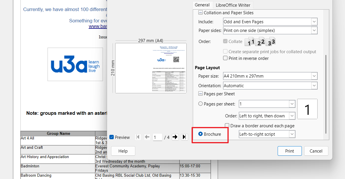

Note:
You do not need to sort the pages for printing yourself. Let the printer handle that.
Keyword: Print as a brochure.

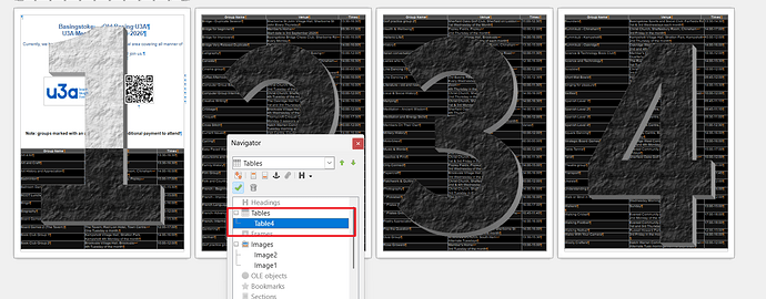

@GRC With @PKG’s trick, you no longer need to split your tables one sub-table per page. You compose your document in reading order. You end up with a single table which is automatically split when needed. This should simplify maintenance.

Print as Brochure.
The document is always printed as brochure and that is why it is laid out as it is. This unfortunately precludes it from being one table.

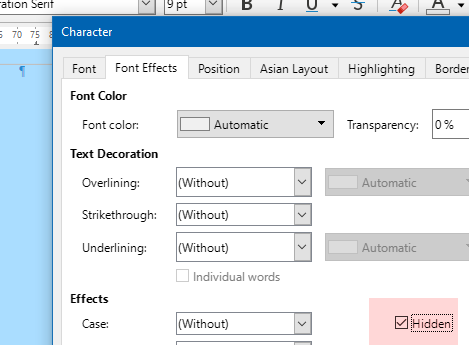

…hide it.

As you want to maintain this document then a single table is easiest. To aid alphabetical sorting I changed the position of the asterisk to the end of the course name so you can use the Table > Sort feature. The asterisk has its own Character style, Big Asterisk, so you can change the appearance to suit.

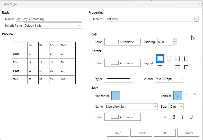

As you are using 26.8 then you have a bit more control over the table styles. For your document, I created a new table style, U3A, and made sure it applied just background row colour and pattern, I left the last row set as Automatic so it will continue the pattern instead of applying its own background colour.
I changed Default Paragraph style to Arial 12 and added your new styles as subsidiaries of Default Paragraph style. I removed all the blank paragraphs and set the two images As Character so they could be centred nicely
The entire document is on A4 size, the intention is to print as brochure so each page will be A5 size. You can either print from LibreOffice, or if you are getting it printed elsewhere, export it to pdf and get the printer company to print as brochure, Adobe Reader is happy to print as Booklet (brochure). As a final option, you could print to pdf as brochure and have it printed normally.

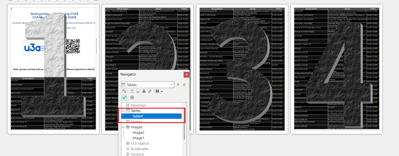

Many thanks to you all for your expert advice. Putting it all together, I have started from scratch using an A5 page style.
Schedule Layour Sept 26 Rev 2.odt (73.4 KB)
I had to use the Table>Autoformat style to get the striped B/G pattern; however, I then had to access the Table Properties and remove the padding.
I will investigate Earnest Al’s method of creating the B/G row colour and pattern as mine is too feint and also creating a character style for the asterisk.
Every couple of months we gain a new group and the challenge is to increase the number of table rows without exceeding four pages.
The document is ultimately distributed as a PDF which members can print as a brochure.

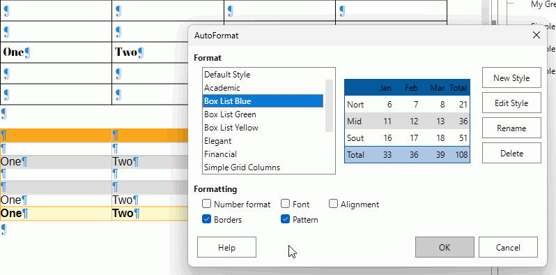

In 26.8 there is no more None for table style, Default Table Style is now what you get for a new table.
The good news is that there is more control over what happens where.
The best news is that changing the style of a table from one of the included table styles to Default Table Style resets everything back to default, that is, Table Contents and Table Heading apply again.
How this works can be seen in the new Table Style dialogue. The only thing is that you cannot change the settings back to Automatic; you must change the table style to Default Table Style and start styling again. On the whole, it is a good step forward towards having table styles work in a similar manner to paragraph styles.
When you apply the table style from Table > AutoFormat Styles you can choose whether or not to apply the text characteristics. If they are not applied, they revert to Table Contents.
