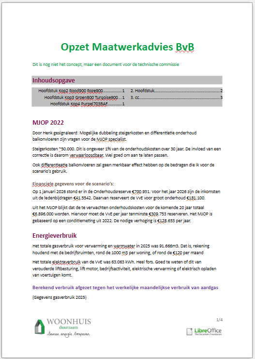

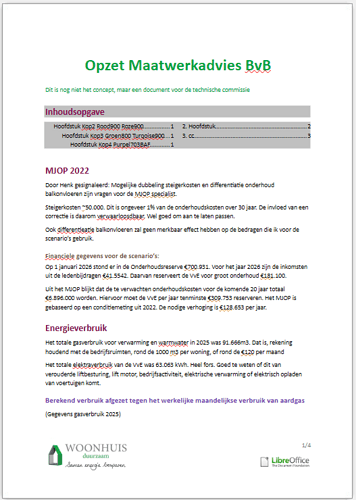

Hi, is anybody interested in a document template with a LibreOffice logo in the footer?
I made it for my one-man-company so all my clients know how i make my PDF documents.
My own logo is on the left side. Both logos have a link to the corresponding website.
Calibri-ColoredChapters-LibreFooter.ott (49.2 KB)
Good job but there are both too much direct formatting and a flaw in style usage.
“Standard” style for text is Body Text, not Default Paragraph Style. The latter is the ultimate ancestor of all other styles which inherits its settings. It is intended to receive your preferred global document-wide preferences. It should not be used anywhere in the document because temptation is too big to customise it for your discourse, forgetting about side effects on all others (or most of them).
Some Heading n paragraphs in your template suffer from direct formatting. Heading 1 has not been configured to account for the number (relying on evenly spaced implicit tab stops). This will cause alignment issues if the number grows too wide.
Many “discourse” paragraphs are Default Paragraph Style with direct formatting instead of Body Text. Even Body Text paragraphs have received direct formatting.
Your sample starts with a Heading 2 without preceding Heading 1. In such a case, Writer creates a “shadow” Heading 1 and your first chapter gets numbered 2 (instead of 1).
Your logos have been manually positioned instead of being controlled by a frame style. This means they won’t react “correctly” to margin adjustments in the page style.

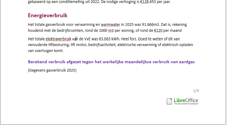

i noticed that strange things happen with the footer and the images in the footer, probably because of the reason you wrote. I don’t know how to not manually position the logos to get them on the right place. Should I use the Crop function together with Align Objects?

Your sample shows you have 2 logos in the footer, one at left, the other one at right. This means you need two frame styles so that you can position differently the logos (one at left of paragraph area, the other at right of paragraph area).
Frames are extremely (this word should be repeated seven times!) sensitive to direct formatting (DF), infinitely more than paragraphs or characters. The least suspicion of a shadow of DF is enough to mess up style application and this kind of DF is so pernicious that it is next to impossible to get rid of it once it is set.
This is why beginners (and even experienced users) often prefer to choose As character anchor which turns the image into a (huge) glyph which is then managed by the standard text flow algorithm. You no longer sweat upon position parameters and don’t fear DF. This is the easiest and most reliable way when your images “integrate” smoothly with your text.
This is probably the solution of choice in your case: first logo As character, a Tab, page number and page count fields, a Tab, LO logo. I have “moved” page number/count in the middle to avoid complex handling of data at right of page (which would necessitate a frame style).
