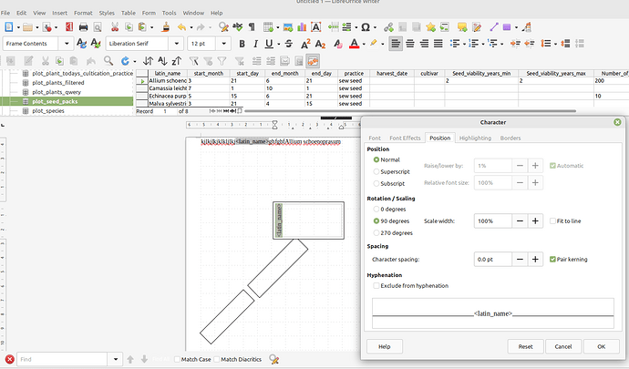

I’d like to print some seed envelopes from the LANdpLAN database. The origami for the envelope necessitates the text be on a 45 degree angle. Is there a way to make a text box that way so that the name of the plant will be in line with edge of the envelope?
This discussion from over a year ago says that the only possibilities are 90 and 270. I need 45.

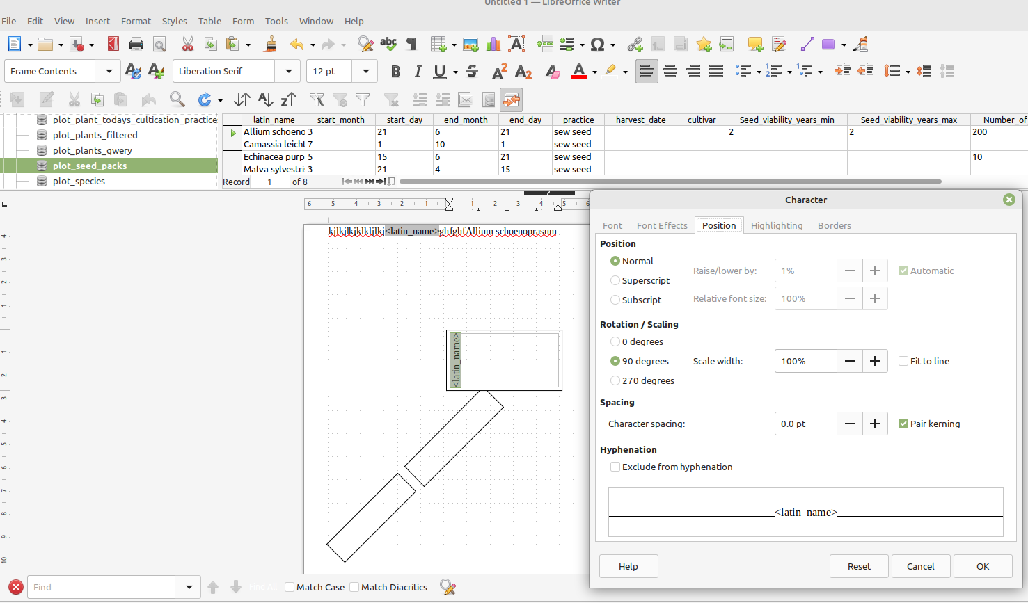

You could try to use mail-merge instead. I remember to have a template including rotated text. Currently constant text, so I have to try to put a field in that part…
I can not insert a field into a text box. I can not rotate a frame 45 degrees. Is there another way?

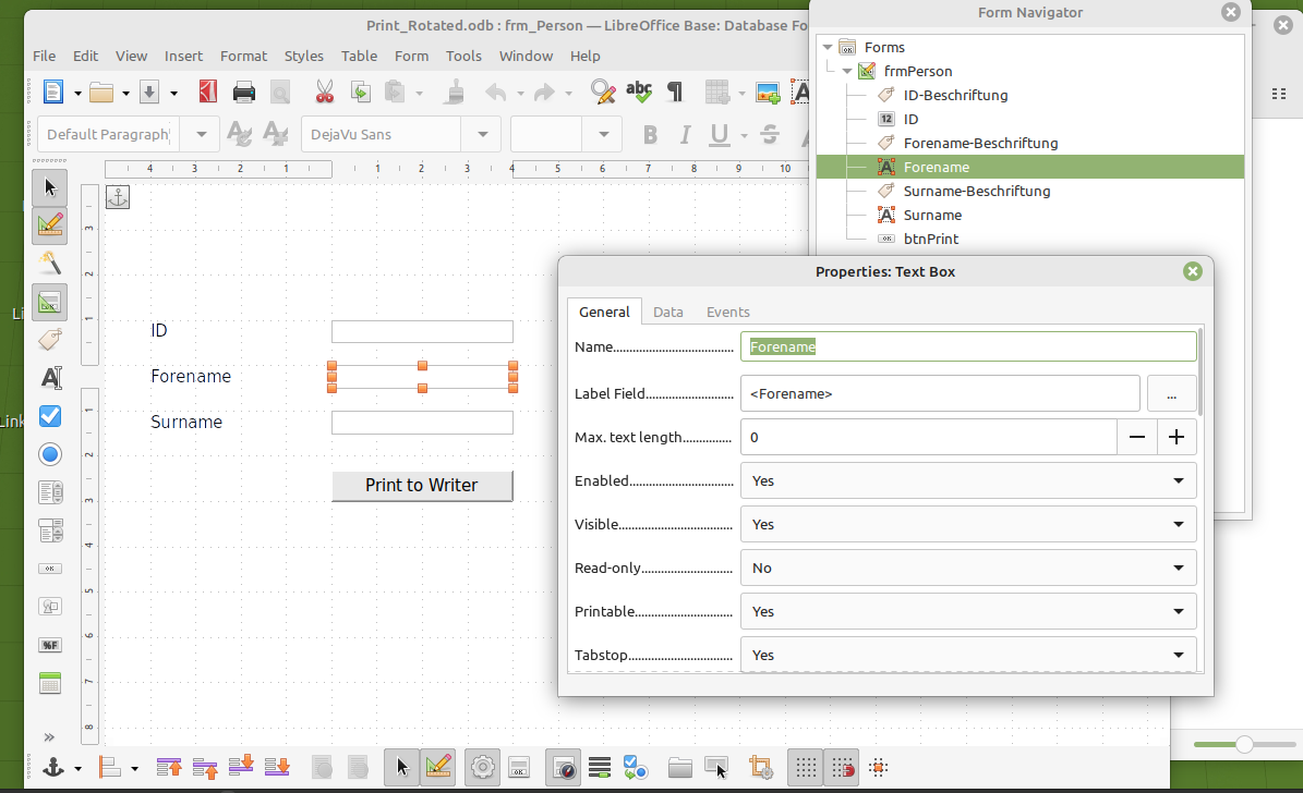

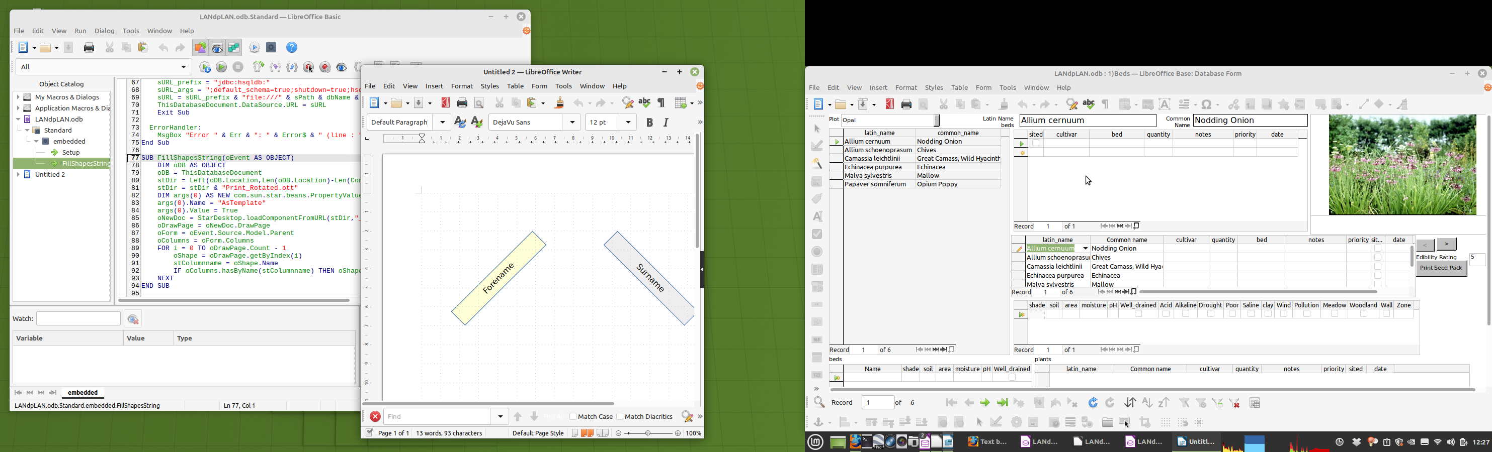

I am able to open it and copy the macro to LANdpLAN. I moved the odt into the LANdpLAN folder with the .odb. It is split HSQL database.
Screenshot from 2026-03-11 11-06-33
I made a print button and copied the macro over…
I press the print button and the result is “Forename” and Surname", not related to LANdpLAN database table.
I’m trying to understand how to edit the macro so that it works for me.

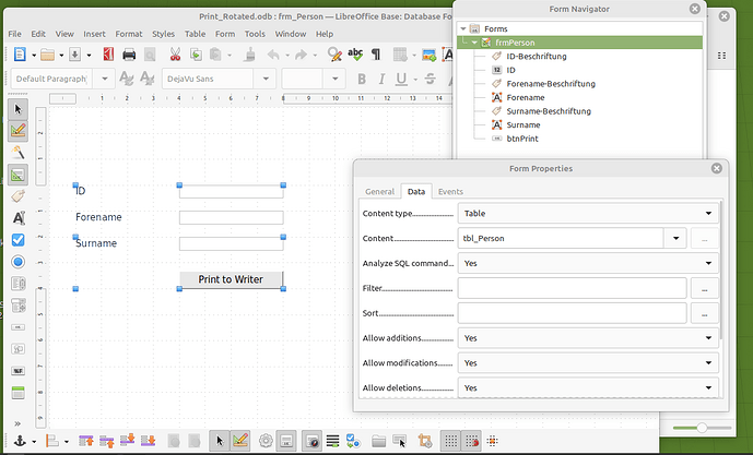

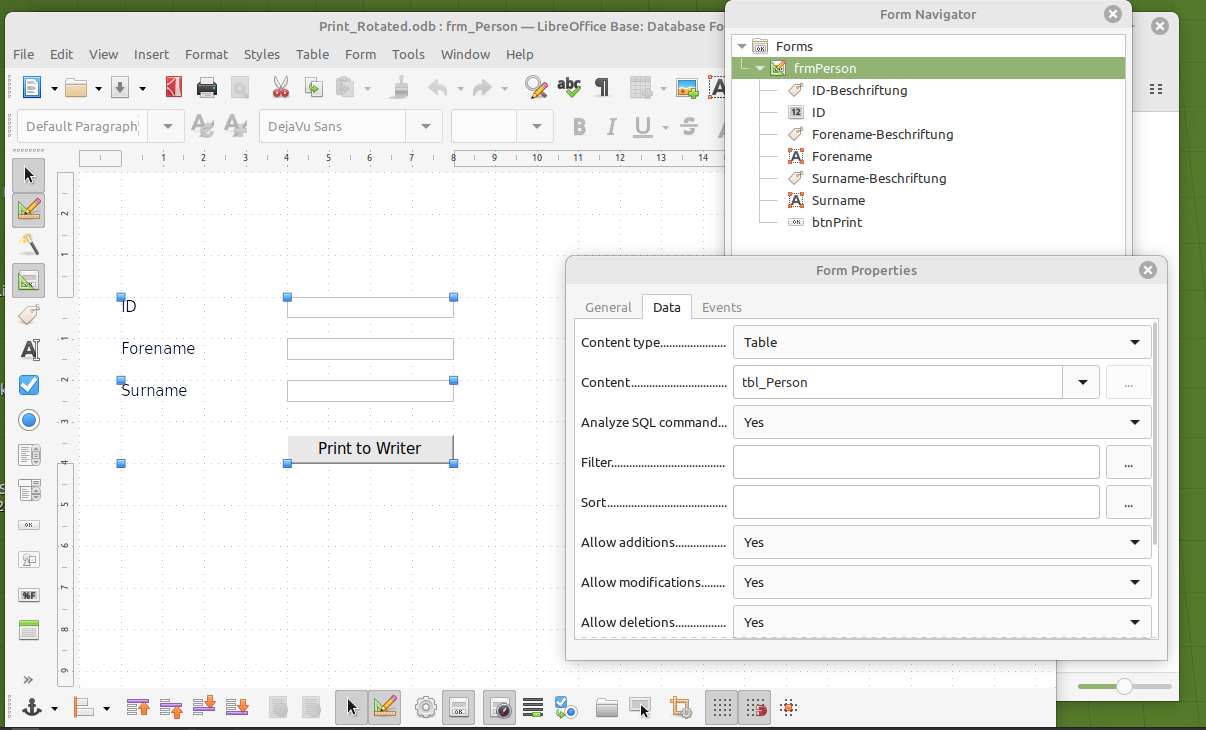

name of the form’s controls are: ID, Forename, Surname
the forms data source is tbl_person
So names of
oForm.Columns = tbl_person columns names.
Form controls (shapes) names
table columns names,
right?

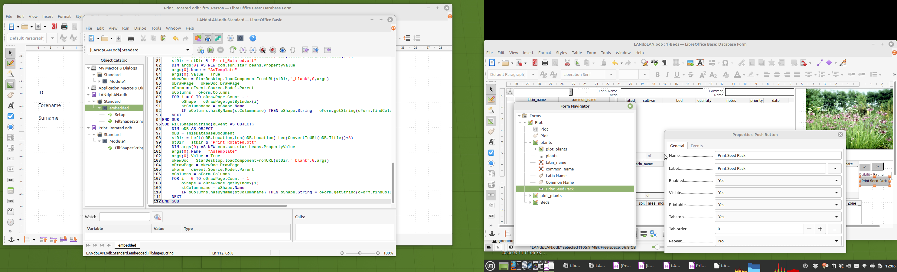

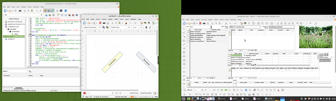

I entered this conversation thread to chat gpt and with it’s help I had success!
The fix (very simple)
You must rename the shapes to match the database column names.
Example:
If your query returns:
latin_name
common_name
family
Then the shapes must be named:
latin_name
common_name
family
How to rename the shapes
In the template document:
  1. Click the rotated text shape.
  2. Open Format → Name…
(or press F4 to open the properties sidebar)
  1. Change Name to the column name.
Example:

  • Create a template with shapes as you need (name of template had been “Print_Rotated.ott”). Template should be saved in the same path as the *.odb-file has been saved.
  • Set name for every shape in navigator of the sidebar the same way as the name of the columns in data source.
  • Put a button in your form (with the data source) and connect the macro to this button.
Template will be started, macro looks for shapes with the same name as the columns in the form (columns of the table - not name of the form controls) and fill the content from the columns to the string of the shapes.
