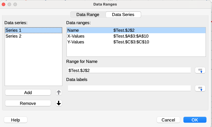

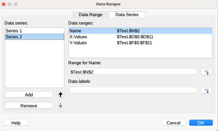

I want to display measurements from two different data sources in an XY chart in LO Calc. These are energy measurements over time, which are updated daily. I import the two measurement series into different data ranges, with the time values ​​and X-values ​​in separate rows. Therefore, the chart has two separate ranges for the X and Y values ​​for each of the two series. For example, I want to display two measurement series from a specific day. This works perfectly with the Chart Wizard by entering the corresponding data ranges in the “Data Series” fields. Here’s a simplified test example:
The Data Range Register then looks like this:

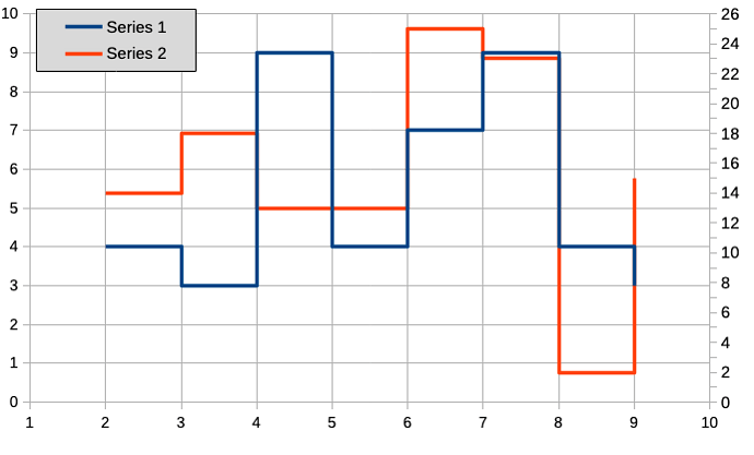

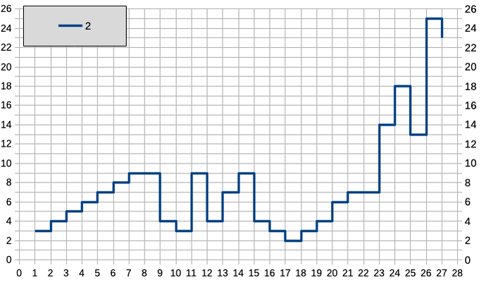

The chart looks as expected:

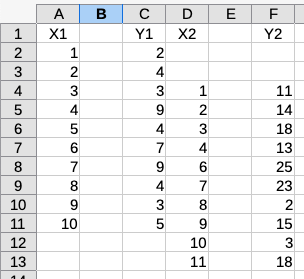

The relevant data:
Chart_data

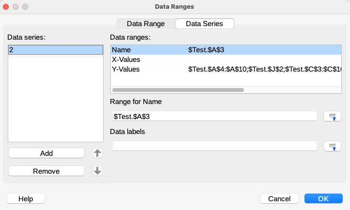

Now I want to change these data ranges using a macro. However, the setRanges method doesn’t work as expected: Changing at least one data range results in:
