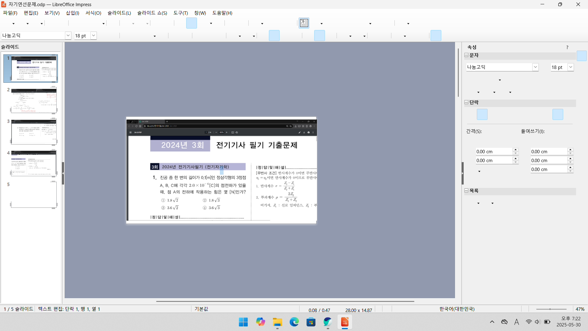

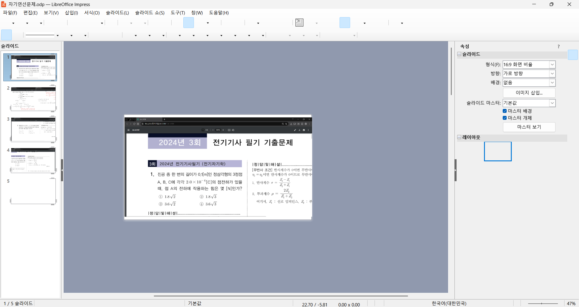

The icons are not appeared
Thanks for the advice but it seems no change.

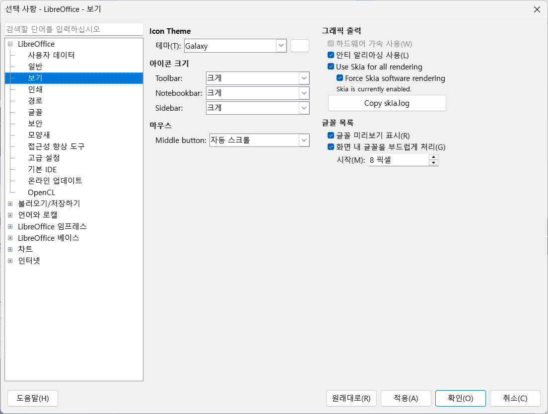

And what icon set is selected currently?
Do you mean this?
Yes; and how did you get that Galaxy there? We don’t have it in the default install set. I assume, you downloaded an extension… What happens with the automatic (Colibre) case?

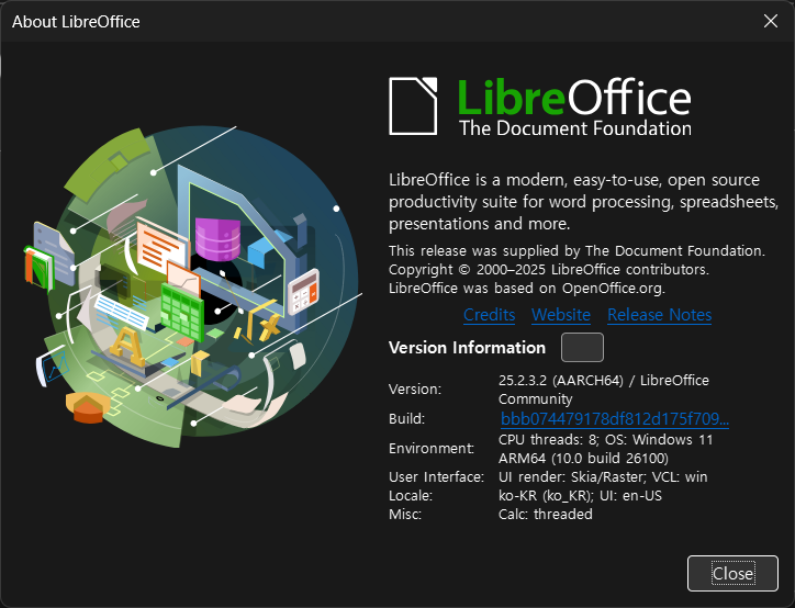

What is the complete content of your Help->About dialog?

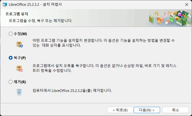

Well, my last idea would be to try to repair the installation (using Windows control panel).
I tried recovery and it took time to reinstall but the icon is not shown.

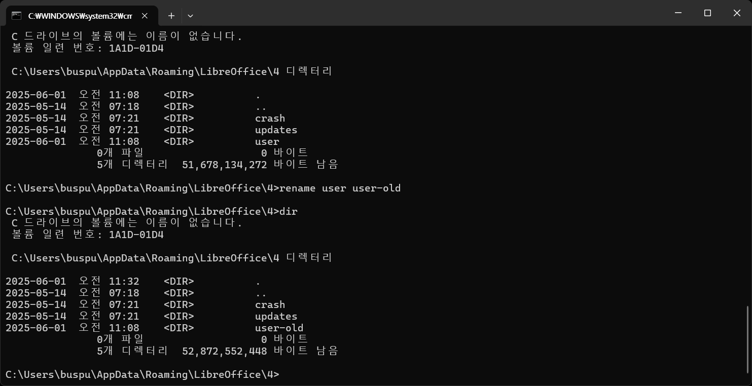

Submitted as tdf#166803 with NEEDINFO status from OP to provide result of clearing user profile.
UserProfile/zh-cn, or guess that should have been UserProfile/ko
I removed Libreoffice and profile.

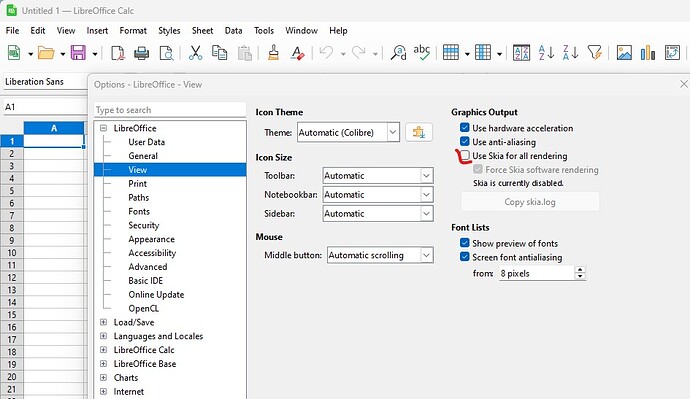

I had the same issue and here is the way I solved the problem :
  • open ‘options’ and select ‘view’
  • uncheck use ‘Skia for all rendering’
This solved the issue ; you may also try to uncheck ‘Use hardware acceleration’

I can confirm this fix worked with Win 11 (Version10.0.26200 Build 26200) Lenovo Yoga 7x slim.
This bug was driving me crazy. Unchecking ‘Use Skia for all rendering’ helped.
Tools → Options → View → ‘Use Skia for all rendering’ (off)
This also appeared to work whether I was in dark mode or light mode.
