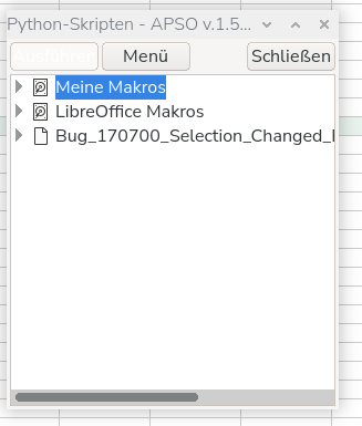

So start with ⇒Tools⇒Makros⇒Organize Python-scripts (shortcut shift alt F11):
20260210_19h39m51s_grim
Take ⇒Menu⇒New Module and choose something sensefull Name, eg. arrayresizer.py
select this arrayresizer-module and ⇒ Menu ⇒ Edit
this will propably open some Texteditor from your OS, copy the given code from above and paste it into your editor. Store the file (ctrl s) and close the Editor.
Now you may select (from your Calcfile where the Sheet with the formula is focused)
⇒Tools ⇒ Macros ⇒ organize python Scripts ⇒ my Macros ⇒ arrayresizer ⇒ resize_formula_arrays and click on execute
