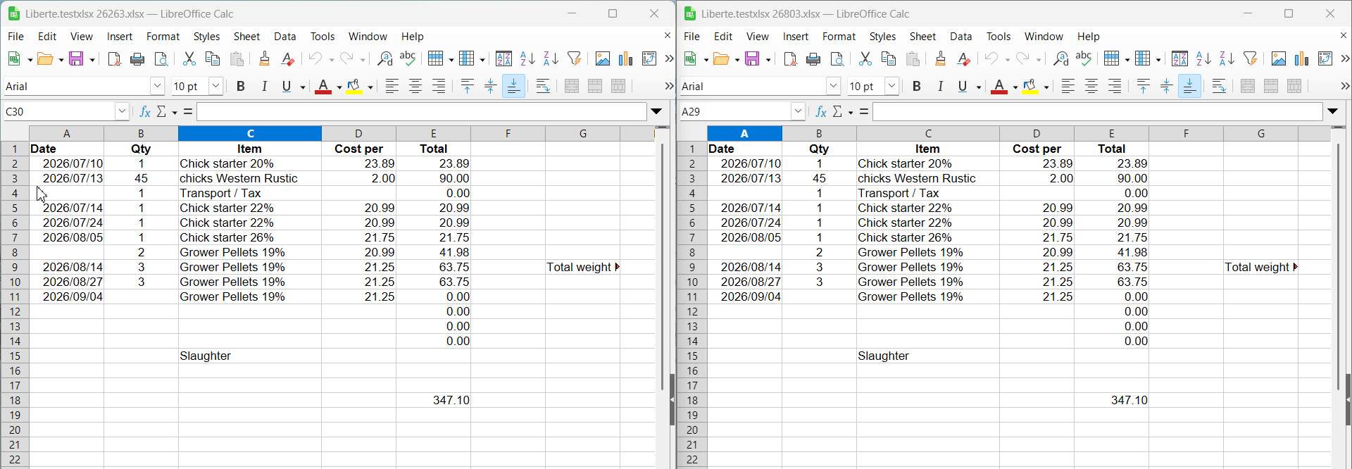

You’re using Data Validity with the formula for the cell ranges B2:B18 and D2:D18:
AND(ISNUMBER(#ref!),NOT(OR(NOT(ISERROR(DATEVALUE(#ref!))),AND(ISNUMBER(#ref!),LEFT(CELL("format",#ref!))="D"))))
Indeed!
Yes, with LibreOffice 26.2.6.3 and no with LibreOffice 26.8.0.3

26263vs26803_Win11
