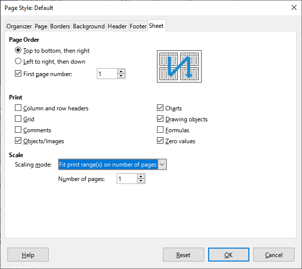

But indeed, it is also possible to set up using page styles, choosing Fit page ranges in Scale section on Sheet tab:
