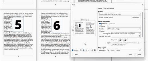

Looking at your screenshot:
  • It seems (I can’t see for sure) that you have the document page in Landscape. If you want two pages in portrait side-by-side then the document page needs to be in Portrait.
  • Don’t set anything to A4 unless you use A4 paper. For USA and Canada set to Letter size.
  • Don’t worry about the Left-to-right script and vice versa, if you don’t have installed languages that read right-to-left you won’t see it.
Have a look at the sample I used for my screenshot.
