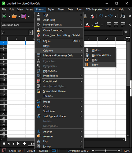

  1. Go to a cell in the hidden column that you need to unhide. To do that, enter L1 into the Name Box, and press Enter:
  1. With the cell selected, use FormatColumnsShow.
Also can be activated with Ctrl+Shift+T.
Also can widen the column with Alt+Right arrow, but this will not preserve the original column width.
Enter a cell address into the name box left of the formula bar, say X1. The unhide command will unhide column X.
