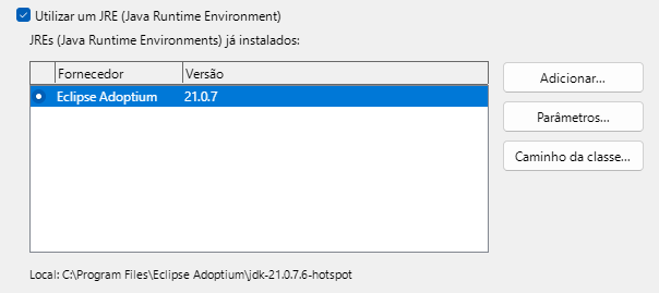

Did you check Java is enabled on her LO classpath?
JavaPath
@CRDF I have not. I only thought of the Java issue this morning and she is on the other side of town and probably still asleep. I know how to check her version of Java; I just have not had a chance yet to do so. (It’s 6:03 AM here.)
She was working fine with the embedded HSQLDB, so I assume she has a working Java on her machine and that LibreOffice can find it. My concern is that perhaps HSQLDB v2.7.4 requires a higher level of Java than she has installed.

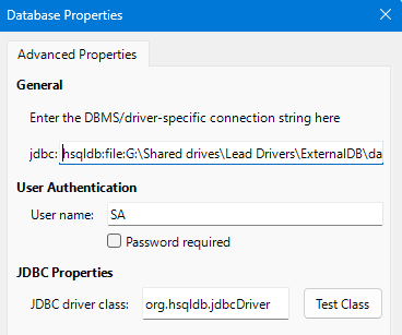

And where is located the MOW DB itself?
How are the strings for these 2 fields?
ConnectHSQLDB
hsqldb:file:/path/database_name;default_schema=true;shutdown=true;hsqldb.default_table_type=cached;get_column_name=false
where “database_name” is the prefix of the respective database files

So, 1st text box gets:
jdbc:hsqldb:file:/path/MOW;default_schema=true;shutdown=true;hsqldb.default_table_type=cached;get_column_name=false
And 2nd (driver class)…

  • Not sure exactly what you are asking about text boxes. Is this it?
The full string above is hsqldb:file:G:\Shared drives\Lead Drivers\ExternalDB\database\MOW;default_schema=true;shutdown=true;hsqldb.default_table_type=cached;get_column_name=false
Thanks for your patience. Did I miss any questions?
Charles
These are the 2 text boxes that appears in (the 2nd window)
Base > Connect to existing DB > JDBC
[Test class]
Just asking… as it’s not working for her.
