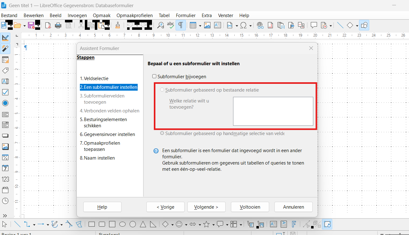

Hi,
I try to use “Subform” to connect to a second table.
However I’m not table to select option: “Subform based on a excisting table” I stays greyed-out
Ron
Hi,
The wizard tries to read it from the relationship in your database. Did you create a relation between the table for the main form and any other table in Tools → Relationship?
Hi RobertG,
Thank you for the fast response
I didnot do that, sounds fair!
Ron
