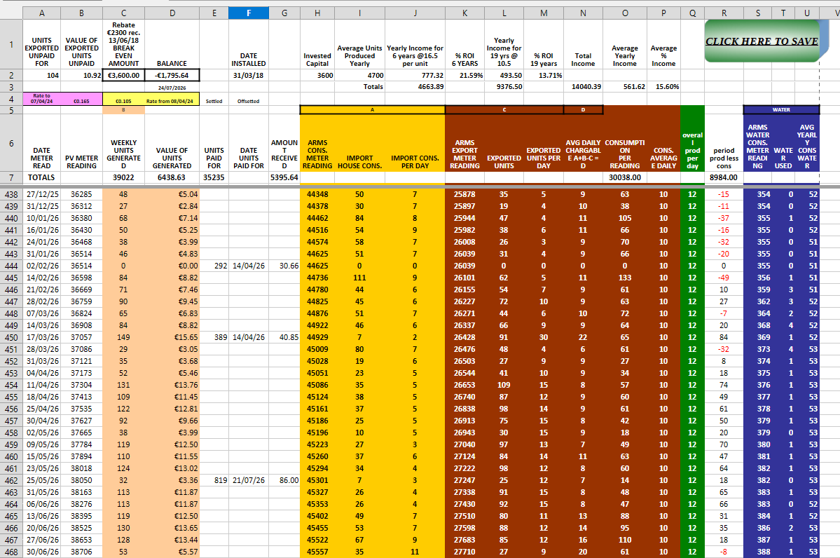

Using the correct formula in calc // Using SUMPRODUCT() or SUMIFS() with ranges containing gaps
this formula works
=SUMPRODUCT((MONTH($readings.$A$9:$A$2000)=1)*(YEAR($readings.$A$9:$A$2000)=2026),$readings.$E$9:$E$2000)
but if I substitute column F instead of A in the criteria it gives the error #VALUE!
What is the solution to get the correct “Settled” value according to the dates in column F

with my configuration 26.2 4.2 W11
give Err508

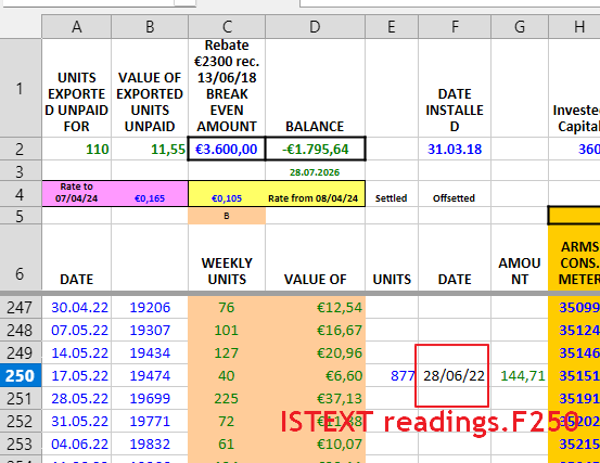

@PawluTaMalta ,
We could have identified the text in column F that caused the “#VALUE” error using a file as early as 4 days ago.

maybe also use MONTH from F instead of mixing A and F ?
@yclik ,
Why do you want to sum the dates in column F?
… to calculate the aggregated duration since 1899-12-30 obviously :rofl: :rofl:
