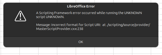

What works for me with .ods in LO on windows gives this error on friends Ubuntu - seems to be running any Macro attached to a button - New_Position.LoadStatusMacro.
Any ideas why?

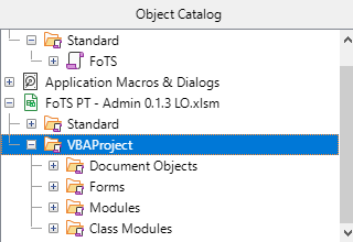

Others I am still struggling with. Well simply cannot do, like call Macros from the Document from within ‘My Macros’, which is a bit of a pain because only Macros within My Macros work when assigned to events.
Macros created by the user can be stored (excluding “exotic” cases):
  1. Within the document (essentially in the \Basic\ folder of the archive structure)
  2. In My Macros… (essentially in the ...\LibreOffice\4\user\basic folder on the disk)
We can assign event handlers (listeners) to both groups of macros.
If an .xlsm document is opened in LibreOffice, the event handlers of this document (created in VBA and contained in the project) will be called.
But I can never get those in the document to work…
Just tested this (document finished loading event) with .ods and does not work… and with xlsm loses the assignment on save.
I have my FoTS specific in the My Macros and VBA modules in VBAProject-> Modules
I am assuming the archive structure is within the xlsm file, which I am loathe to even look at, let alone edit!
