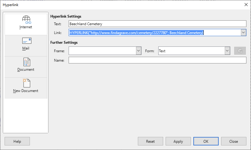

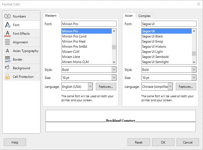

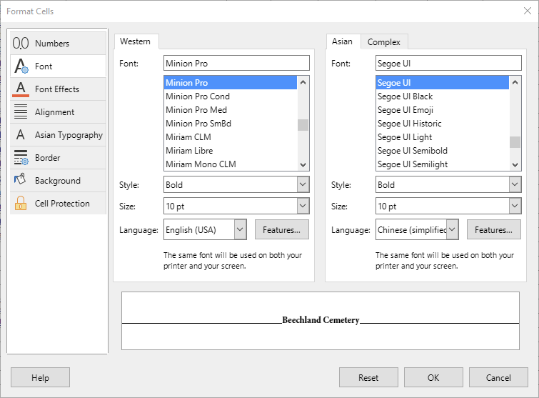

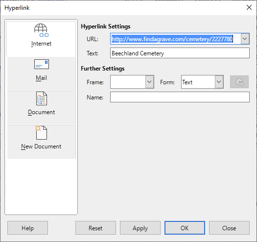

With cell A3 selected, Ctrl+K
Alt+F12

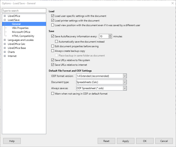

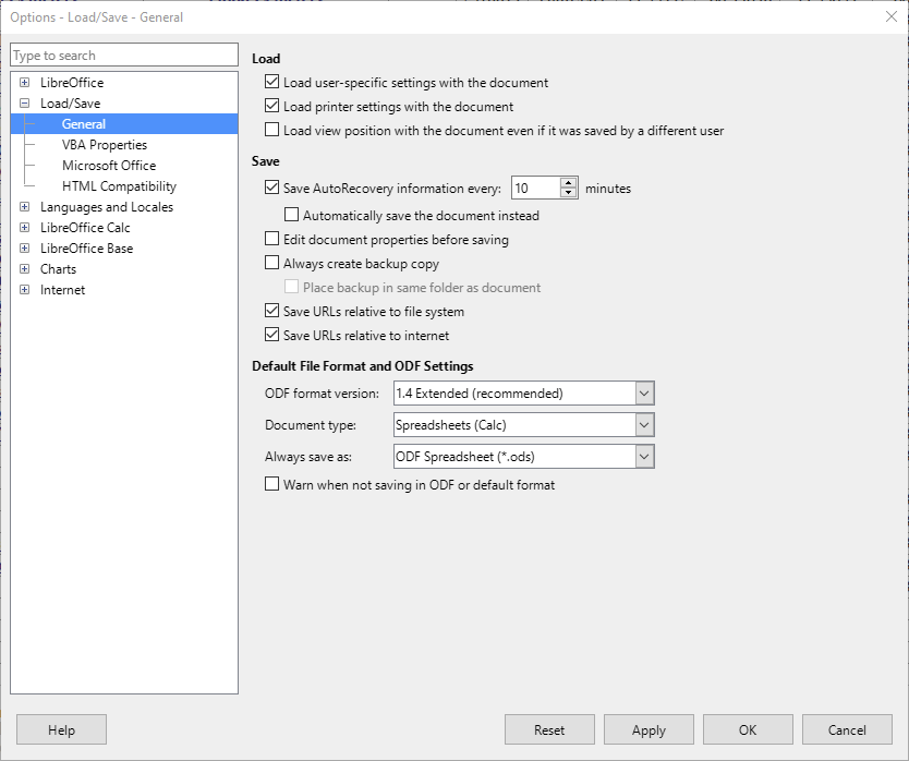

Options, Load/Save, General

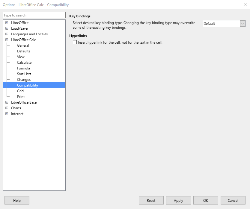

Options, LibreOffice Calc, Compatibility

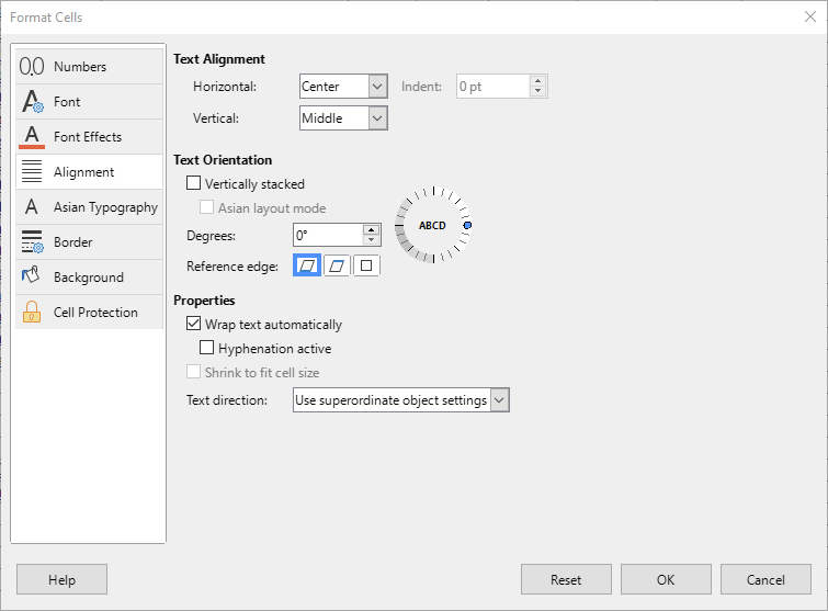

Ctrl+1
Format, Cells…, Alignment,
Format, Cells…, Font,

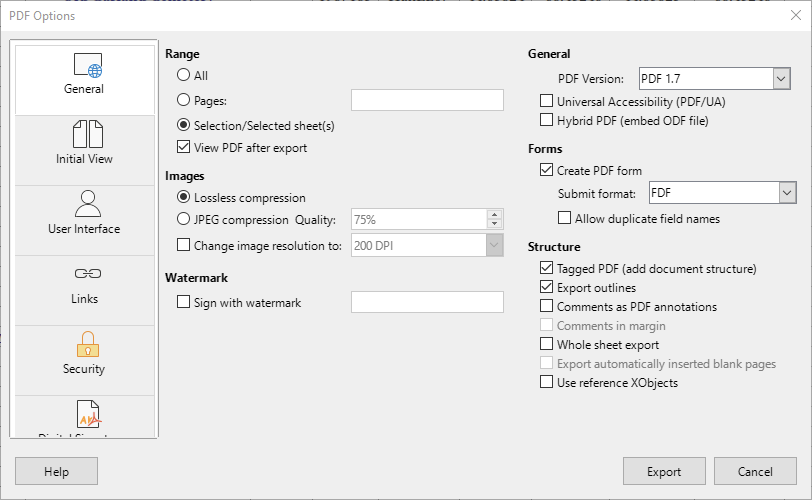

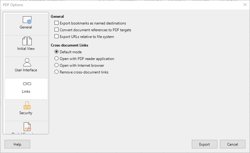

File, Export as PDF…, PDF Options, General
File, Export as PDF…, PDF Options, Links,
The problem is when you use the Insert hyperlink and you have active the Warp Text automatically in the page Alignment.

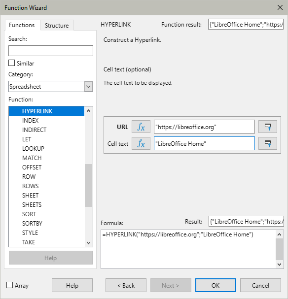

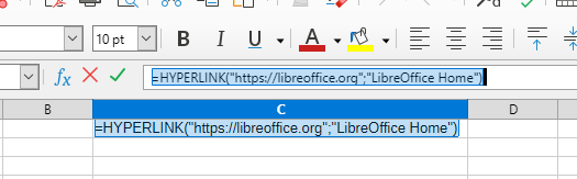

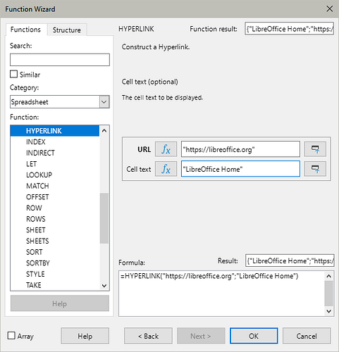

You mus NOT use the Menu > Insert > Hyperlink
You must use the function HYPERLINK:
  • Delete previous hyperlink
  • Place the cursor in the cell and write direct in the cell the function HYPERLINK
=HYPERLINK("https://libreoffice.org";"LibreOffice Home")
you can also use the function Wizard
@bantoniof Thank you for clearing that up; and that the Function Wizard or Formula bar must be used.
That link worked, though the styling associated with hyperlinks no longer appears
Do you think that this is the new norm for LibreOffice or do you imagine that it’s just a work around until the bug(s) discovered in December 2025 gets fixed?
Until then, I’m thinking that maybe v25.8.6 is a better work around.
I don’t know if the HYPERLINK function existed before or after the Insert > Hyperkink menú option.
  • Apparently, when you insert a hyperlink with the menu and you have auto-wrap text enabled, Calc sections the text to fit the width of the cell and breaks the hyperlink when export to PDF.
  • This doesn’t happen with the function because it treats it differently.
I’ve uninstalled v26 and gone back to the previous version of LO and note that the v26 version doesn’t have the URL: field name given in the Ctrl+K Hyperlink dialog. Also, the Text: field is switched in position.

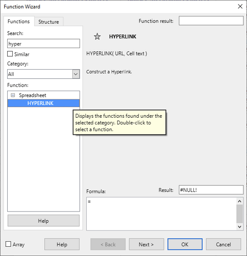

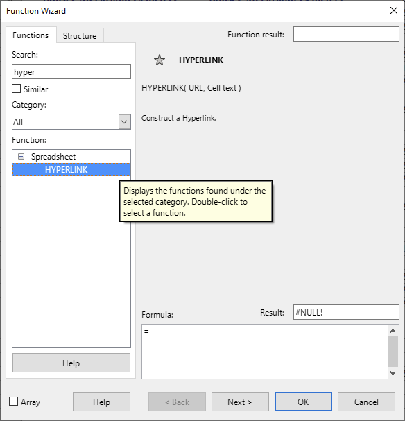

As for the existence of HYPERLINK in the Function Wizard, Formula toolbar, HYPERLINK is in:

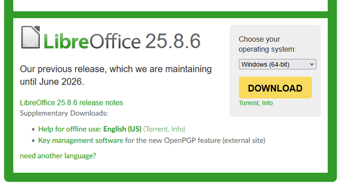

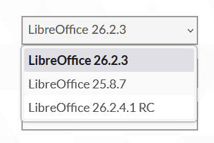

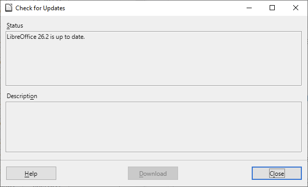

Has anybody tested this issue in any of these current offerings?
I’m currently still using:
Version: 25.8.6.2 (X86_64)
Build ID: b4b39682cd9868fa725bc664aff94278d315bd04
CPU threads: 12; OS: Windows 10 X86_64 (build 19045); UI render: Skia/Raster; VCL: win
