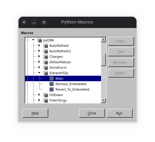

Download the attachment from Apache OpenOffice Community Forum - [Python] Macro to extract and reconnect embedded HSQLDB - (View topic)
It’s a Writer document with a push button installing the macro.
Bildschirmfoto vom 2026-01-31 19-14-08
Within your profile folder, the path to the script is Scripts/python/pyDBA/ExtractHSQL.py
