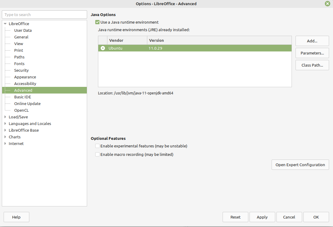

You are using external HSQLDB. So might be it is the JRE, which slows down the database. Had tested this sometimes ago: Scrolling to the end of a table with internal HSQLDB was 30 seconds, while internal Firebird does the job in 1 second. You haven’t written which Java version you have installed.
