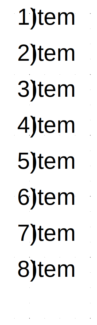

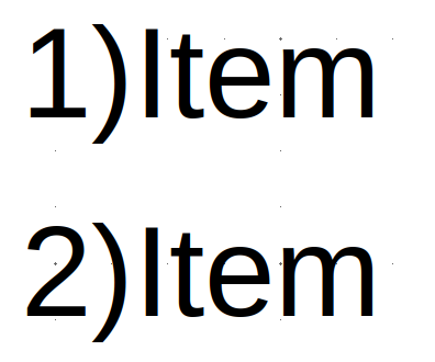

I am using LibreOffice (v7.3.7.2) Impress (on Ubuntu). I am a bit at loss and dissatisfied how difficult it is to create reasonable looking ordered lists. I am starting off with a blank document and add an ordered list, which at first looks good:

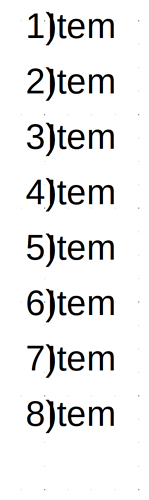

but after adding more items Impress adaptively changes so all items fit on the slide and the format completely falls apart. I really don’t understand how this is the default behaviour:
What can I do to stop this behaviour ideally as default for all new documents?
Select your list
  1. Click Format > Bullets and Numbering
  2. In the Bullets and Numbering dialogue, set Width to 2.00 cm (or to suit). OK
Do you know how I can make this the default?
Click Apply to Master in the Bullets and Numbering dialogue. Then save as Template I suppose.
