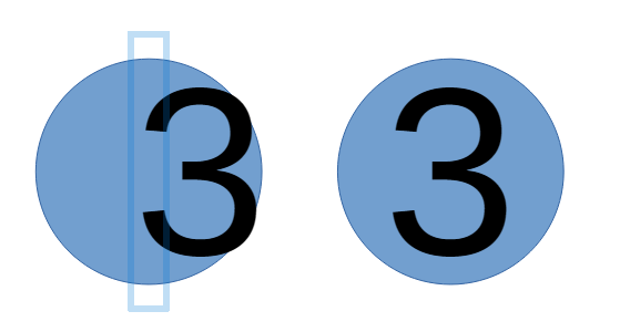

I am trying to create simple, numbered “reference bubbles” on an image. A circle shape with light shading and a numeric text value centered within. I’ve been fighting with Draw to center my text if the size is anything but quite small.
In the below example, the text is being rendered off-center due to the font size, but as you can see the font size is FAR from exceeding the bounds of the circle.

If I reduce the font size significantly or make the shape much larger, the text is centered, or at least -more- centered:

This shows the position of the text box in the circle and is basically what I would expect:

But look what happens when I make the circle smaller:
And when you exit edit mode, does it look like mine in the right side?

It does not; it stays the same. I received help on a Reddit post and someone suggested I turn off text wrap on the Style and that gave me the results I was looking for. I’m curious if you have text wrap enabled in your example?
Right click > Edit Style > Text > Custom Shape Text > Word wrap text in shape

You’re right, I should have included in my message. I simply created the circle and then pressed the 3 key to enter a 3. I’ve also done but by pressing F2 to edit “text edit mode”. I’m not creating separate objects, at least not directly.
If your text does not keep centred when you change font size, you probably have a space at left of your digit.
