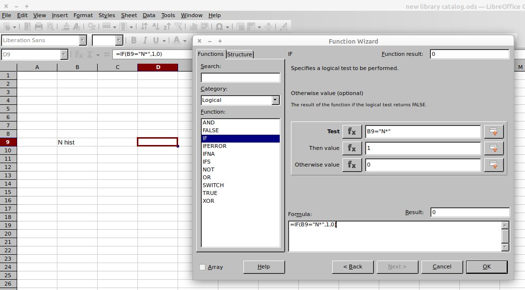

Hi, can someone explain why this wild card isnt woring? Yes i have them enabeled, i even have one working on a different sheet with no difference that i can see.
thanks!
You probably need something like =IF(ISNA(MATCH("N*";B9;0));0;1)
See Calculate
is it ?
i found a work around using ISNUMBER(), but would really like to understand what im doing wrong. the wildcard works fine a COUNTIFS equation. does it really not work in IF?
According to the HELP, no. Scroll down to Supported Spreadsheet Functions.
From the help I linked
Enable wildcards in formulae
Specifies that wildcards are enabled when searching and also for character string comparisons. This relates to the database functions, and to LOOKUP, VLOOKUP, HLOOKUP, MATCH, AVERAGEIF, AVERAGEIFS, COUNTIF, COUNTIFS, SUMIF, SUMIFS and SEARCH.
The simplest formula, =IF(LEFT(B9;1)="N";1;0), finds only upper case N, the one I gave earlier finds upper and lower case N
