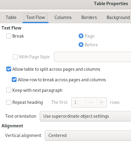

Use a table cell; see the last field: Vertical alignment.
