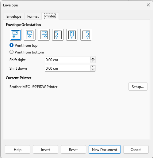

If you are using Insert > Envelope, have you checked out the tab in the dialogue named Printer? You should be able to set up the envelope and printer in it.
